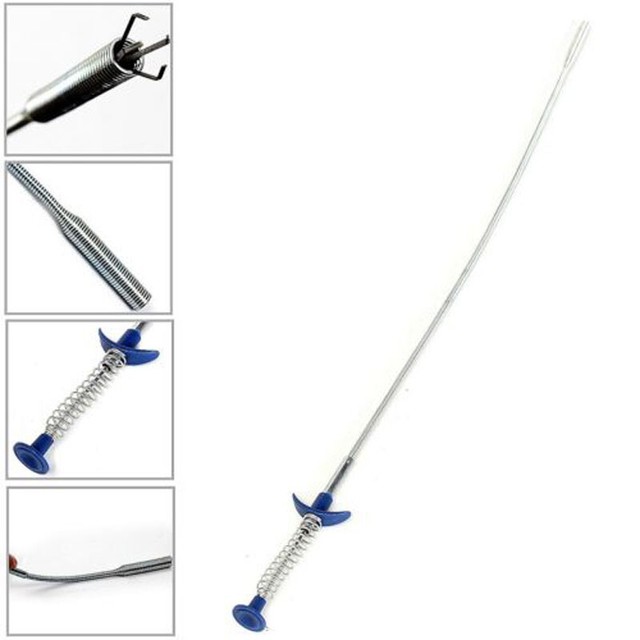

So this is a bit of a retrofit as the IFR kit came out after my tail was closed up. The instructions call for running the coax down the VS and into the tailcone (right in the center, 3? from the aft edge of the tailcone.
The coax is then routed thru a zip tie which is affixed to the right-side rudder guide, and then it continues forward along a J channel..all the way to the baggage bulkhead.
My question is, how do I get that ziptie on that rudder cable guide? Do I remove the tail feathers and try to do something through the HS counterweight hole? Or is my only option to go into the cone, essentially all the way to the tail bulkhead?
I got as far as routing the cable and putting on loose zipties... but i?m not sure if i?ll actually fit too many body parts thru the last tailcone rib.

Ask around to find out if any of your friends have any really long hemostats. I picked up a big pair long ago that have a really long nose and have used them quite often. I have not done what you are trying to accomplish but I have used hemostats to install wire ties in tight places in the past.
The good thing about using a hemostat as opposed to pliers is they are thin giving you more maneuvering room and they will lock onto the wire tie so you won't have to worry about dropping the wire tie as you position it and maneuver the free end into the locking tab.

Harbor Freight sells a long-handled one very cheap ($5?). Has been very useful during my build.

You can also use an inexpensive long reach "claw" tool.
These are great for pulling wires through tight areas.

I also have a couple of hemostats that are great because they lock and also ended up getting this at Walmart.com for just $5.86 and it's 36" long https://www.walmart.com/ip/X-Long-36...ll&athena=true
