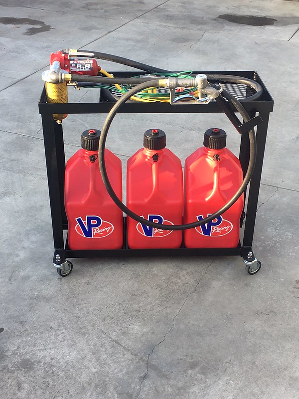

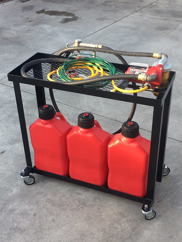

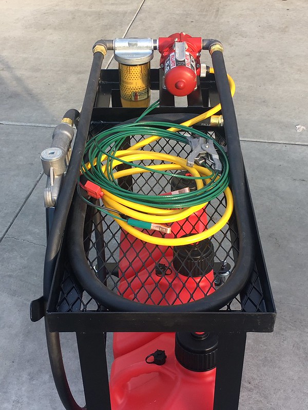

I fuel with MoGas in my hangar. I built this "fuel cart". The jugs are just shy of 6 gallons each, the pump is 12 volt, designed for gasoline and pumps 8 gallons / minute.The filter is 17 micron with water block. The pump came with hoses that have a ground bond so the fuel is grounded from the container to the nozzle. The cart is grounded to the aircraft with a 1/8" vinyl coated cable 12' long. Another 12' cable connects the cart to the hangar ground. Total investment minus battery and labor $425.00.
I spent a lot of time struggling over the grounding issue, read a lot and decided it was important, the reason for the design and pump / hose I used.

seagull 04-24-2020 03:21 PM
fuel handling safety article
The Cafe foundation link did not work directly for me either. I found the article another way. For those that can't get the link to work I put the .pdf on my google drive with a link below. Hope that helps.
https://drive.google.com/file/d/19IU...ew?usp=sharing

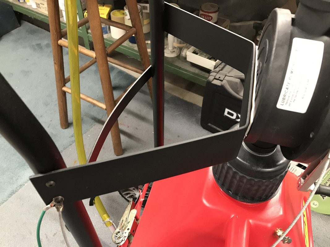

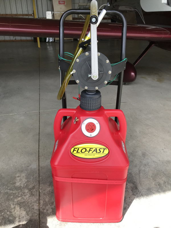

Piper J3 05-04-2020 02:43 PM
Update on FLO-FAST 15-Gallon Filler System

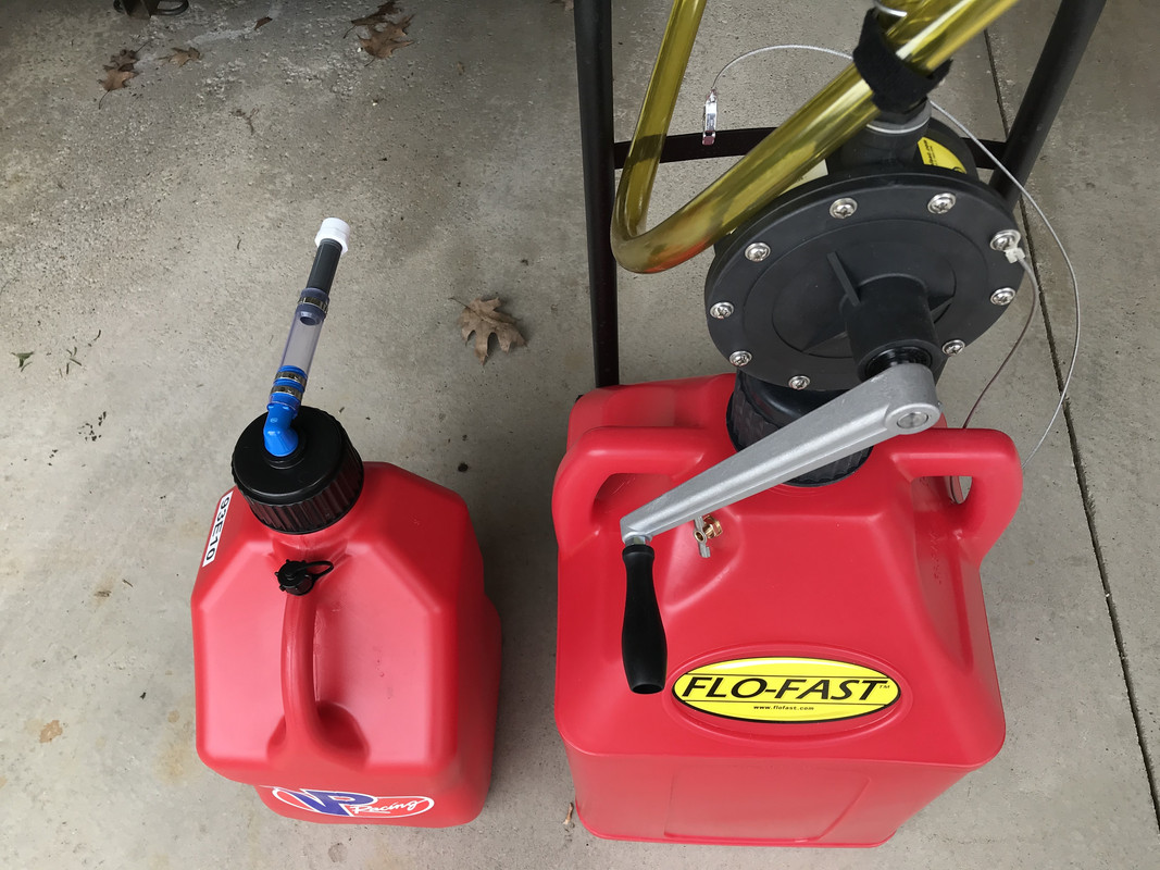

I added 90 degree PVC fitting (3/4NPT x 1? Barb) to top of each 5-gallon Racing Jug so they will fit within the height of my car and also facilitate pouring into 15-gallon FLO-FAST container.
I mounted the 15-gallon FLO-FAST container on a two-wheel hand-cart using a ratchet strap to hold it in place. Then I added a metal bracket to support the hand-crank pump to keep it from rotating when turning the handle. Back of pump is fastened to the bracket with double-sided foam tape. Works a charm...

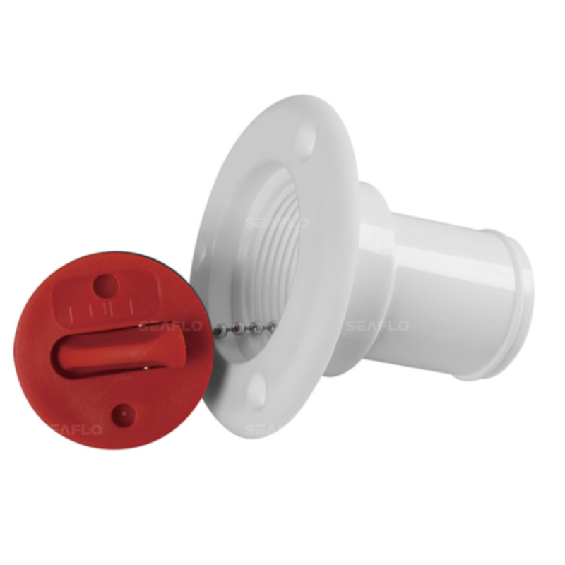

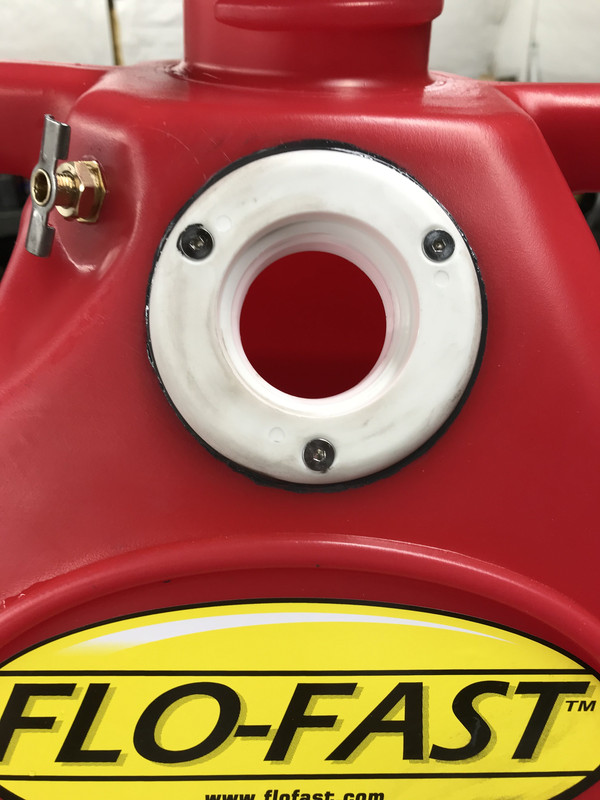

Then I added a filler port to the 15-gallon FLO-FAST container so I don?t have to remove the pump when adding fuel. I bought a Boat Deck Fill Tank Fuel Flange on eBay and installed it above the 15-gallon fill line using Pro-Seal fuel tank sealant.

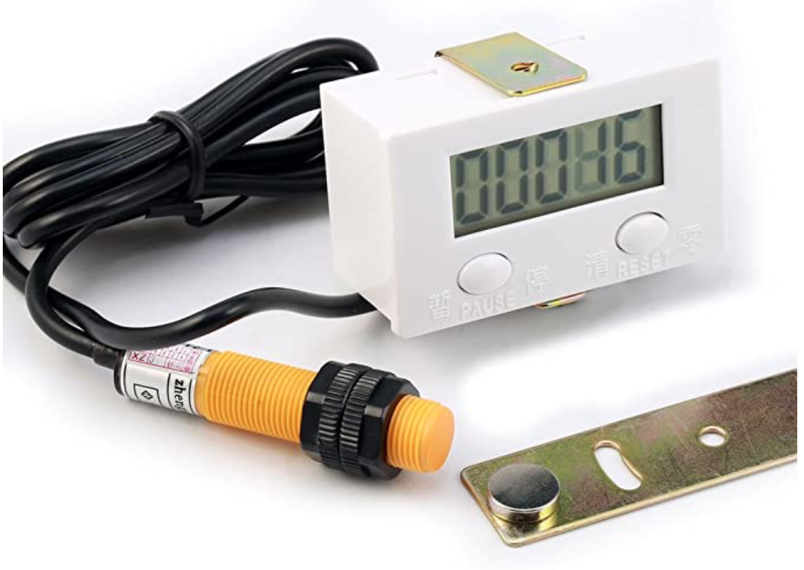

Next, I?m going to add an electronic counter ($12 Amazon) to count pump handle rotations so I can correlate # turns/gallon.

Hey Jim,
The flat metal brace you put behind the pump, and secured to the cart, is it lite steel or aluminum? If you bought the piece somewhere let me know please. If you cut it out from larger stock that’s good to know to.
I’m looking at some of my scrap at home and at the hangar but not finding a piece like seen in your photo. Thanks
MVPILOT 05-07-2020 02:37 PM

The FLO-FAST pump has a ground wire attached to the pump. I attach it to the two-wheel cart and then a wire from the cart gets attached to the tail tie down ring.
Piper J3 05-07-2020 05:22 PM
Strap is made from Home Depot mild steel strip.
Piper J3 05-07-2020 05:43 PM

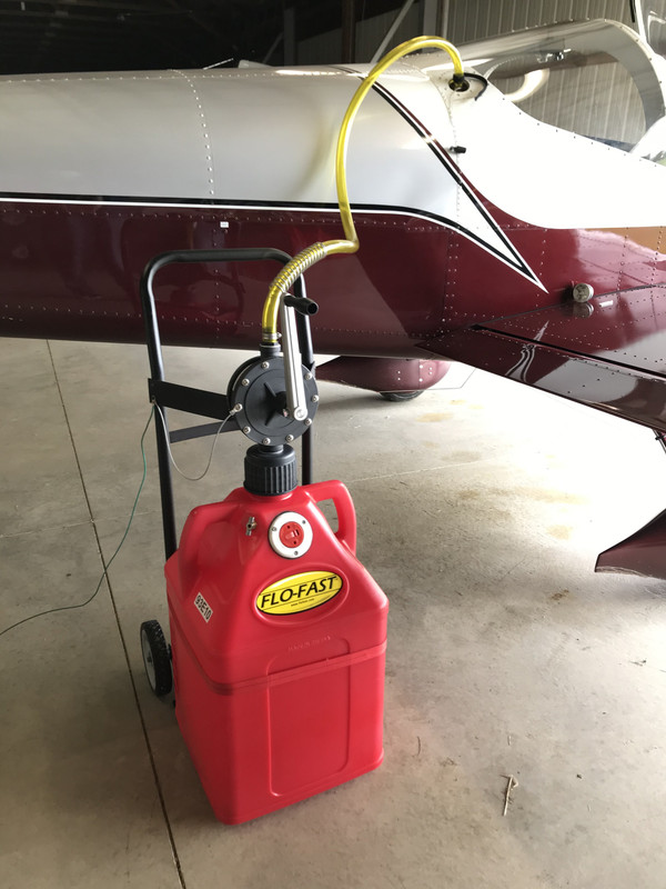

Update 5-7-20
I finally got to try the entire system now that the Pro Seal has cured on the boat deck filler tank flange. Absolutely the nuts? I?m through lifting 5-gallon gas cans to shoulder height to pour into the RV-12. The FLO-FAST pump is easy to turn and outputs about one gallon for 10 turns. Today I rec?d the digital rev counter and I will make that part of the system and report out when complete.
I changed the 5-gallon pouring snout ? it is now a straight piece of ?? ID FLO-FAST tubing. This makes it easier to pour into the boat deck filler flange. I also changed the way the 5-gallon jug vents to allow a more vertical (fast) pour. This is still a work in progress but looks very promising. I?ll post photos when complete.
Suffice to say, I am very happy with the FLO-FAST. This should help me fly another 10+ years at which point I will be in my late 70?s? God willing.

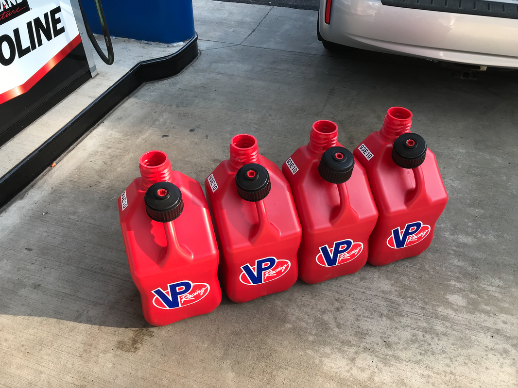

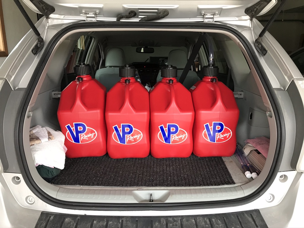

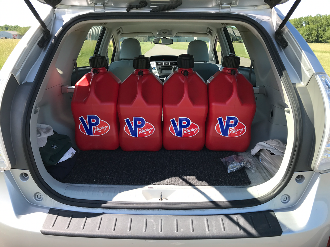

For those using the Flo-Fast storage containers, have you found the container seal to be airtight? I am using standard 5 gallon containers and always get fuel fumes filling my car. I am willing to spend the extra money to have a secure leak-proof sealed container, but don't want to invest a lot to find out I'm wrong. Thanks.
Piper J3 07-01-2020 01:30 PM
These work great. Tight seal and no fumes in the car with jugs full or empty.
Amazon - 4 Pack VP 5 Gallon Square Red Racing Utility Jugs with 4 Deluxe Filler Hoses $120
