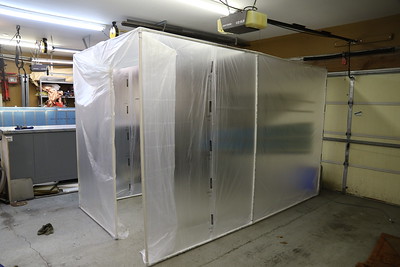

For a quicky paint booth I bought a 10' x 10' plastic garage from Harbor Freight $69. I set a canvas drop cloth under it. But could have used blue tarp. I cut a hole in the wall for two 24" square fans and put double furnace filters on them. The fans blow outward. When you spray the over spray goes into the furnace filters due to the fans pulling the air. Replace the filters often, but they are cheap $3. Some photos here: http://www.mykitlog.com/users/catego...category=11091

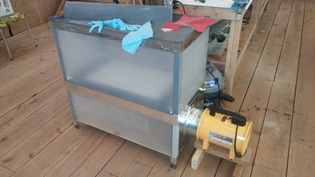

A primer booth is just a 36" high box with a chicken wire top. One wall of the box has an HVAC filter, behind which is a fan. When the fan is running, air is pulled down into the box and through the filter. If positioned against an exterior wall, the fan can dump outside.
You can also stack filters, remove almost all the overspray, and allow the exhaust back into the room. It removes solids, but not solvents.
The concept is an industry standard for both paint and sanding.

I did this:
https://www.brunbergs.net/2015/11/23...rt-paint-hood/
https://www.brunbergs.net/2015/11/29/paint-hood-plus/

I stapled a 10x15' sheet of plastic to the rafters in the garage as the roof. Then took a 12x50 foot sheet and stapled it around the edges to form the walls. Duct tape to seal the seams and a 20 inch box fan as the air mover. On the exhaust side I used a couple 2x4s to build a frame for a household ac intake filter. Used a couple painters throw clothes on the ground to catch the overspray. Pictures on on the website in my sig. I think in total I was out 75 bucks and a day to build the booth. It rolls up above the garage door and gets clamped to the rafters when not in use.
http://www.rv7build.com/weather-hold-6-hrs/
