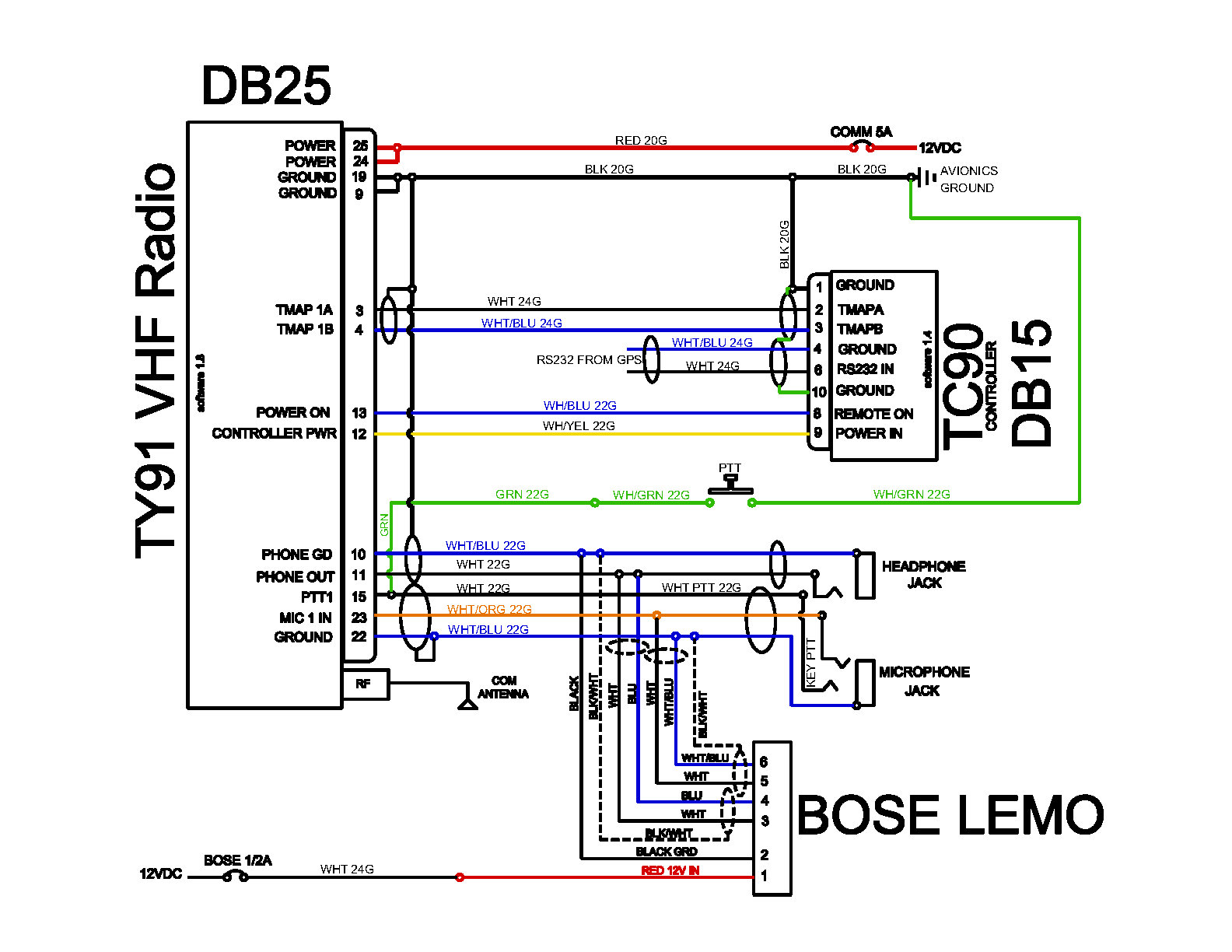

jliltd 04-23-2020 12:25 AM
RV3 LEMO Plug
Here is what I did in my RV-3B. If you look at the bottom portion of the diagram it shows how to hook the LEMO wires to legacy headset jacks. This makes it really easy to add LEMO.
jliltd 04-23-2020 08:49 AM
Originally Posted by Bob Y (Post 1424688)
To reduce the potential for induced noise, I would highly recommend taking the negative of the power circuit - black LEMO lead - to the airframe ground vs. through the audio panel. It might work ok, but why introduce the potential risk?
As a rule of thumb I might agree. In fact I take it one step further than you and make sure any system device such as this gets its power ground from the common avionics ground point. But in this case I followed instructions. Bose specifically specifies these exact wire connections in its documentation and on on its drawing. I speculate that Bose realized if they showed the black wire going to ground the installer might decide to ground locally rather than the avionics ground point, which could induce ground loop interference. So while I stick to generally accepted practices like the avionics ground point when no guidance is given, when a manufacturer like Bose says to do it a certain way who am I to argue? And my installation works great.
Jim

I should mention now that after my initial wiring of the plugs in April, I finally got around to testing it with a headset. I found that I had no audio in my right-ear.
After much head scratching, it turns out that the LEMO diagram in the latest RV-12 electrical diagram was incorrect. After consulting with the mothership, it appears that someone cut-pasted the RV-14 diagram into the RV-12 schematics. While the wiring is essentially the same, the RV-14 uses a different wire color for headset-ground and headset-right. (white/orange and white/blue are swapped).

The ground wire on a lemo connector feeds both the power ground AND the headset speaker ground. I believe it is recommended that this ground wire connect to the intercom ground buss or headset ground pin, depending upon intercom type. Connecting the lemo ground pin to an airframe ground introduces the risk of a ground loop on arguably the device most sensitive to ground loops, the headset speakers..
Larry
Larry
Larry. Good catch. You are correct.
That is depicted 8 posts up in the drawing. The LEMO ground is attached to the headphone ground circuit per Bose's instructions.
