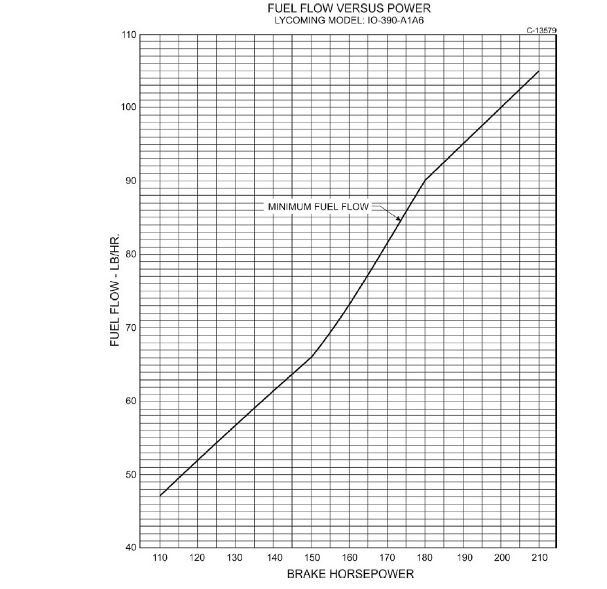

I did similar test but raised the fuel line so pump was pumping uphill similar to a steep climb. Still got way more GPH than needed.
This is from the Lycoming manual for the IO390. Max fuel flow 105lbs per hr at 210HP. That's roughly 17.5GPH
That is MIN fuel flow not max.
You should have around a BSFC of 0.58 and that will be 20.0 - 20.5 USG/Hr based on ISA and sea level. This should be checked because every new Lycoming with the Avstar FI servo that I have seen has been below min spec and has been removed and sent to a workshop to correct it. Many more out there not flowing enough. :( |

The BSFC might not be higher. Lets assume you have a 0.58 on a ISA day at sea level. You take off at -10dC and with a QNH of say 1030.
Lots more mass air flow, lots more HP, and a proportional increase in fuel flow. BSFC is the same. In a TCM engine your flow will be constant, thus lower BSFC than normal and a leaner mixture. |

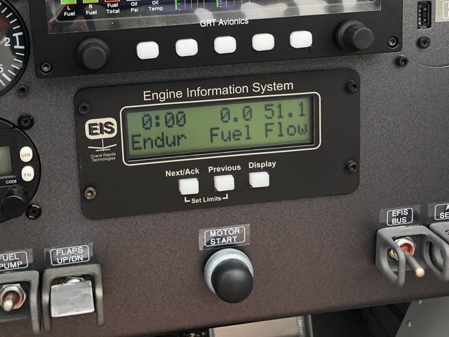

Fuel flow
RV-14A. Andair electric pump with wing-root mounted Andair gascolator (70 micron mesh). 1.5 gallon fuel in the the tank. Fuel line disconnected at the FM-150 fuel servo and tied up on that level.
Level flight attitude and 15 degrees nose up (mains on the floor and tail on the floor). Both attitudes: around 36 GPH. Please put your mains on blocks and tail down to get to 20 degrees or more nose up. I would love to have those fuel flow numbers. Will be interesting to know what is the degrees nose up at Vx (70 kts). Maybe 20 degrees, maybe more. |
Andair fuel flow
I got around 50 GPH when I did my fuel flow test at just over 16 degrees nose up, hose disconnected just before the fuel servo. The Andair data sheet says open flow of 55-60 GPH @ 5 PSI.
