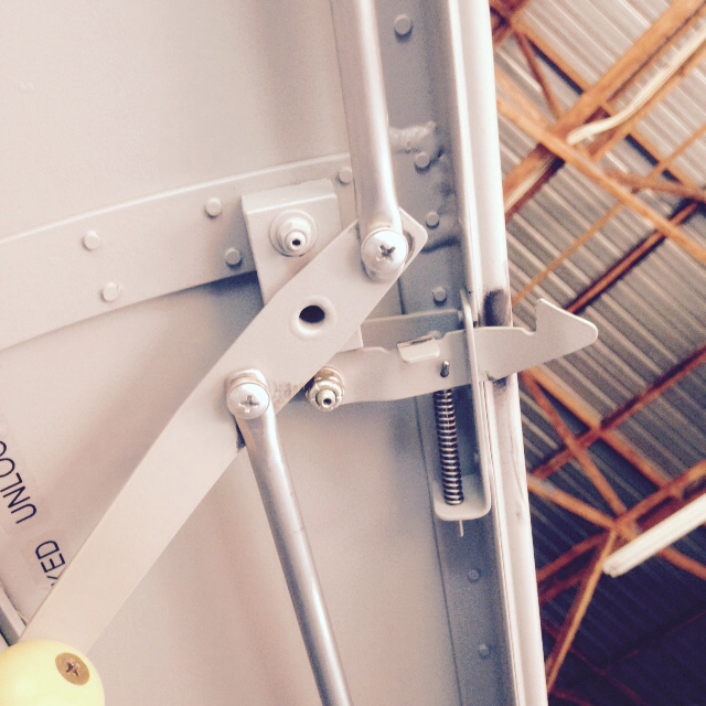

egp8111 04-17-2020 09:08 AM
Here's a pic( I hope) of the Vans safety latch. Like Bill E. says simple and effective

Toobuilder 04-17-2020 10:43 AM
Originally Posted by Clouddancer (Post 1420771)
Some questions to Michael (Toolbuilder):
I assume the rod end was needed because the over center lock or is there another reason?
Did you use other rods than originaly specified to screw in the rod end?
Yes, to allow the handle to rotate through 180 degrees. A fork on the front rod won't work (double shear).
I changed the front rod to steel so I could weld in a threaded stud for the rod end and also a washer at the front guide location to act as a positive stop for the over center action. The rod end simply adjusts to set the tension.
