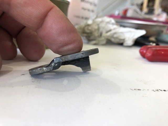

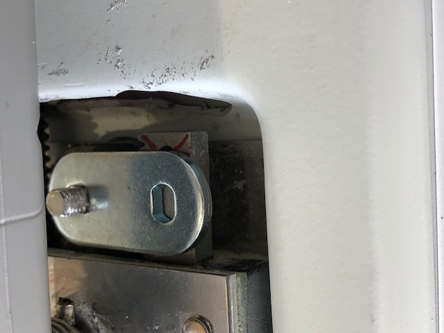

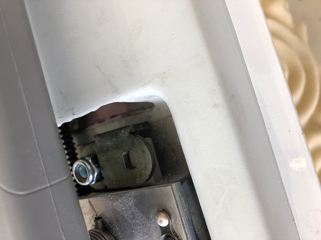

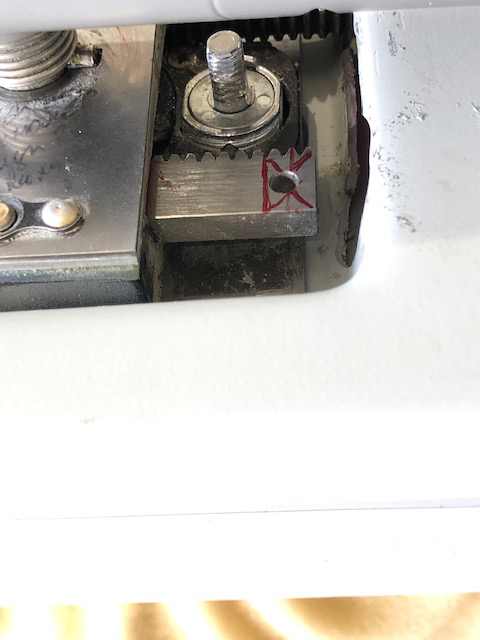

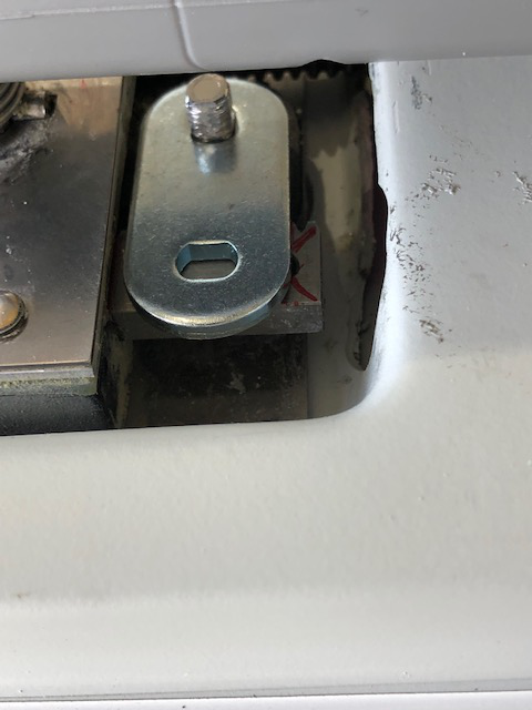

The problem with this setup is that the door handle can overpower the lock as the door lock pin can push the latch up and allow the pin to come out of the notch. I made a latch that goes behind the rack and prevents it from moving more than 1/8" or so. I would post pix but can't figure out how to do it on this site. |
Hi Again. I think I got the pix thing sorted out. Here is how I made the Aerosport covers work without modification.
![]() Lock latch prior to modification ![]() Rack marked for trimming ![]() Tab before modification / welding ![]() Welded tab ![]() Unlocked position ![]() Locked position |

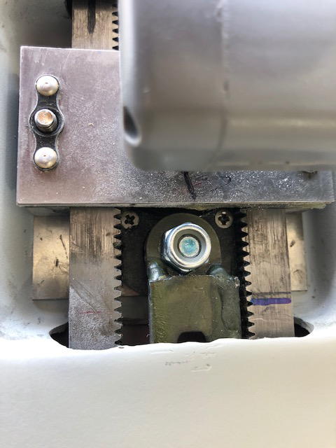

And, with Les' help, developing his idea a little further... I re-woked a short length of angle bar. Same principle and a very secure lock. Note that the nyloc nut needs to be pinned in place to prevent it working loose over time.
