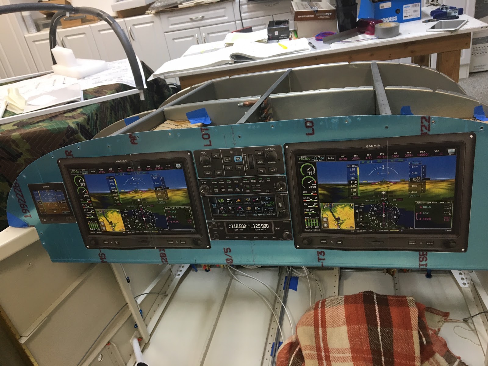

Hi all,
i am looking at my subpanel layout for my RV9 and want to know what everyone thinks.
My equipment not on the panel is all Garmin:
G3X displays (GDU 430)
GNX 375 GPS/ xpnder
GNC 255 Com1 / nav
GMA 245 Audio panel
GMC 507 Autopilot controller
G5 backup attitude
Behind the panel:
GSU25 ADHARS
GMA245R (GTR20) Remote Radio
GEA24 Engine interface
GAD 29 ARNIC interface
GAD 27 Airframe Interface (flaps, etc)
Here is my layout.
Please provide comments on the layout, especially the pieces on the subpanel.

Panel looks very nice. Great job mocking up boxes behind panel. One suggestion: switch the GEA24 with the GAD29 box as the GAD29 interfaces with the GTN650 and the GEA24 has all the engine probes that will pass through the firewall and can be tied along the outer edge under the panel until going through the firewall. I have a very similar setup in my -7 which has worked very well for me. If you'd like me to send a few pictures of my panel/subpanel, private message me your email. (I don't do well with posting pics!)

Very nice. Is there a back-up IFR nav to the 375? I see a lot of IFR glass panels with just one box for IFR navigation and approaches. Wondering if I?m missing something. Not criticizing. Just curious.

Backup to GNX375? yes I am running a VOR in one of the com/nav radio.
hiland 03-16-2020 09:16 PM
Ah. That explains it. Thanks. I figured I must be missing something.

Sit in the plane and imagine accessing every connection, and box reaching through the hole made by removing the screens in the panel. Only you can judge that. Nice looking panel. What are you doing for CB?s or fuses?
I mounted my transponder and ADSB receiver on the ribs in front of the sub panel thinking the likelihood of needing to get to them was slim....until I did the Dynon ADSB upgrade. Got it done but it could have been a lot easier.
