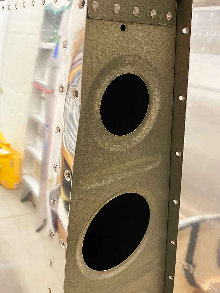

Well target fixation shot me down in flames :( The right wing temp bolts were removed and the right wingtip was sitting on a saw horse. The left wing was being a little stubborn and while wiggling the left wing the right wing fell off the sawhorse :eek: Bent the flap, aileron and bottom skin. How could I be so stupid :confused: The aileron and skins can be repaired I think. But the flap may require new skin. Aileron: ![]() Aileron: ![]() Flap: ![]() Flap: ![]() Bottom Skin: ![]() Bottom: ![]() |

I don?t know....that injury looks workable. A low fatigue area.
Oak dowl , metal working hammer. Base on what I see. Some of your photos I cannot see. R |

That looks workable with a rubber mallet and a "custom" bucking-backing bar for the trailing edge. Use a "fresh" rubber mallet. One that's sat on the bench in the sunlight for awhile will act like a metal hammer as far as the aluminum is concerned.
The toughest task is the "fold line" along the rib in Pictures #5&6. Not sure what to say about what appears to be a depression in the skin (Picture #2) just forward of the trailing edge - would need more pictures. In pictures 3 & 4, return the "dip" to normal profile first. Leave it in and it will work against your further efforts. Use a "custom ground" bucking bar ground to the radius. In picture #4, once the dip is restored, I'd start with an offset bucking bar on the shop head of the rivet and attempt a "push" with the heel of your hand to get a feel. Or judicious use of the rubber mallet. Keep the force low, almost like your trying NOT to move the metal. Make haste slowly and you may stay in front of creating more complications for yourself. Fixing this will take less time, overall, than it will take to rebuild the part. finally, is the black line on the trailing edge of the rib, just that or a crack? Go patiently and you'll have better luck. If you have more questions PM me with your phone # FWIW |
