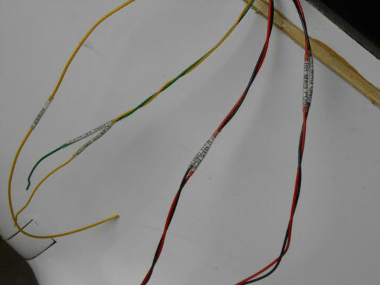

p51dplt 02-09-2020 10:10 PM
Wire Labels
What have everyone used for heat shrink labels for doing wire labels on 22g wires and up?
I am starting a total rewire and avionic upgrade and am looking for suggestions.
Thanks!
N804RV 02-09-2020 10:25 PM
I'm using a Dymo Rhino 5200. It takes several sized of heat shrink.
GeoffP 02-10-2020 12:42 AM
Dymo Rhino 4200 for me.
N514CL 02-10-2020 06:14 AM
DYMO 4200 as well. The OEM cartridges are expensive, so I bought the aftermarket ones on Amazon, which are about 1/3 the price they work just as well.

Same here. Dymo 4200 with after market cartridges. Just did autopilot installed and worked great down to 22 gauge wire for the 1/4" sleeves.

Same here when I built my Rv-10. On the 9-A I bought the Dymo 4200 along with three (3) 3-packs for assorted shrink tube cartridges, 1/2", 3/8", & 1/4". That investment was just under $100 total from Amazon and was one of the best tools I bought for wiring.
scard 02-11-2020 08:38 AM
Does that 1/4" tubing shrink down onto a #22 wire?
I have an old K-Sun tube printer, but the materials are three times the cost.
az_gila 02-11-2020 08:54 AM
Yes..

The 1/4" A18051 heat shrink tubing works OK up to 22 or 24 AWG. For 26 and higher the tubing doesn't shrink enough to really grip the wire.
The Dymo LabelManager 160 likes to waste label tubing (and other label material). Type in as many as you can (a space or two between labels) before printing, print and then cut them with scissors. Of course you can hand-write on the wasted blank pieces of tubing. The 5' was not enough for all my wiring -- had to buy a second cartridge. Tempting to not have the tube sticking out (clear the opening) before printing but often will wrap around the roller and waste even more.
