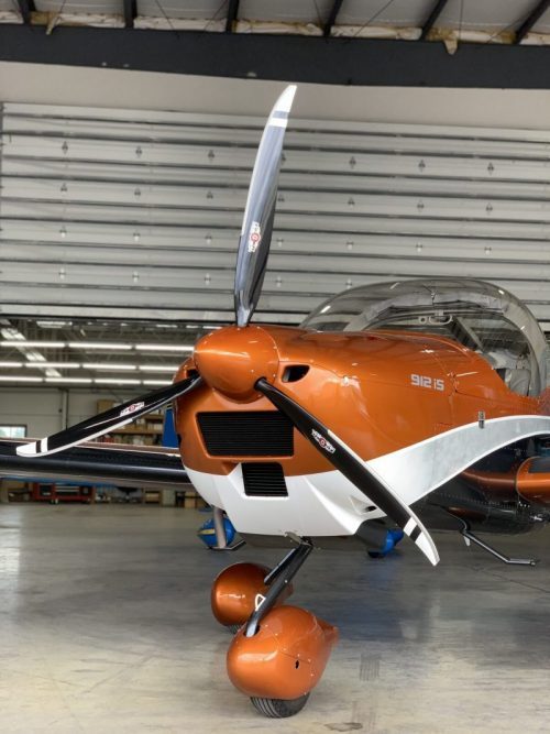

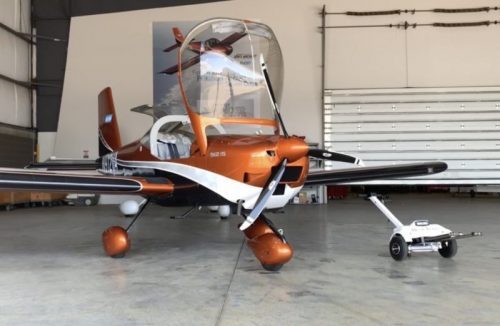

We displayed this prop on a stand in our booth at Oshkosh last year and flew it to the show on one of our factory aircraft. It garnered quite a bit of interest. Now that the engineering has been completed and testing of the final install package is all wrapped up, the three-blade prop and spinner kit is available to order as an option on new powerplant kit orders (you'll get to choose either a two-blade or three-blade prop when you order). You can also place a stand-alone order for the prop without the rest of the Powerplant kit (just use the powerplant kit order form and select only the 3-blade prop option in that case). Note that when building your airplane, in order to register ELSA the parts - including the propeller - must be bought directly from Van's and tracked in our records under that aircraft serial number. Once an aircraft has been licensed and registered ELSA you may, of course, make any changes as you wish. People will, of course, want to know what's different between the two-blade and three-blade prop. Our testing experience showed that:
And, of course, there's the aesthetics: The blades are wider on the two-blade prop. Some folks prefer the look of three blades, while others prefer two. Some people like a thinner blade, while others prefer the "beefier" look. ![]() ![]() |

I am glad to hear that your experience parallels what we discovered. That the original 3 blade with wide cord blades did not perform up to the level of the two blade. We just didn’t feel that we could promote it as a viable option with the only virtue being cool factor, at the expense of slightly reduced performance. Though to some, the skinny blades don’t have the same wow factor, but it at least does provide a slight performance boost over the two blade (as mentioned.... a modest increase in climb rate while maintaining the same cruise performance). Because of some refinement that Sensenich was able to do to the hub while changing the blade design (likely allowable because the blades were lighter as well) the overall weight of the 3 blade install is lighter than the two blade which is good for helping to maximize useful load. The weight reduction is at a less than ideal location as far as baggage payload goes, but it doesn’t seem to be a factor on RV-12’s that have a standard build configuration. Once dynamically balanced well, it is very smooth. The simplification and weight reduction do come at a price (besides just the higher cost)......... there is now 3 blades that need to be adjusted to have closely matching pitch angles, and there is no indexing methods incorporated into the propeller. Not a big loss in my mind because they don’t work well enough to set the blade pitch close enough to each other to get it running real smooth anyway. Just something to be aware of though. |

One benefit over the two blade is that the hub design is different in such a way that the propeller can be removed from the engine as a complete assembly without disturbing the blade pitch adjustment. This also allows for disassembly or assembly of the propeller with it laying on a work table. |

Seemed hard to believe when we first weighed it but each blade is quite a bit lighter than the what a 2 blade blade is, plus the lower hub mass. It all adds up...... |
