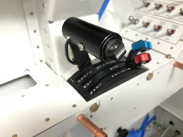

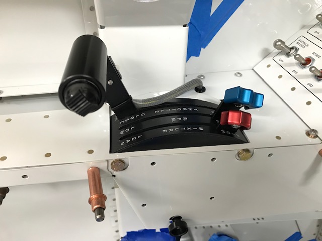

For some background, I?m a USAF pilot, having flown T-38s and F-16s. In those jets, the comm control is on the throttle controlled by a switch that had a Forward and Aft position that would auto return to center. Each position would key the Mic for each radio. For example, in the T-38 forward would be UHF and aft would be VHF. I am trying to set up my RV-8 in a similar manner. I have an IFD-440 as my Comm1, a Dynon comm radio as my Comm 2 and both go into a Garmin 345 audio panel. I am trying to have one position key the mic for one radio, the other position key the mic for the other, and the center just be intercom.
I found the below throttle which is CLOSE to what I want. Although, talking to Paul the owner, how he has it set up is one position keys the radio, the other keys in intercom and the center is off. He was unsure how to set it up like I am requesting but said if someone could figure it out he?d make it! Has anyone tackled this before or knows how it could be done with the below product or know of another switch that would allow it?

I am of the same way of thinking. On my RV-8, I have a standard throttle on the left side. The handle is basically a tube, so I installed a miniature coolie hat switch in the end of the tube. Pushed forward, it keys the mic, and it is spring loaded to center. Then I got to thinking, why not put the flaps on the up and down functions of the switch. So for flap operation, I don't have to take my hand off the throttle. Still nothing in the aft position, but I guess I could make it key my #2 radio.
For wiring, I made a slightly thicker throttle arm, then cut a slot in the back side to allow a ribbon of wire to nest down the back side. Works fine, and hopefully will last a long time.

That quadrant is made by Dayton Murdock (DJM, Mfg) and the grip is an overlay that goes on tope of it.
Why don't you try to contact Dayton and see if he can't turn out what you are looking for?

I used this, glued into a sleeve that slides into the standard DJM handle and is retained with a small screw.. Drilled a small exit hole for the wires and secured to the lever.
