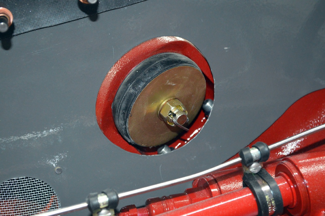

The picture below is the baffle at the rear of the engine with the top motor mount protruding through it. I'm looking for an easy effective way to plug up/cover this huge pressure leak.
Kyle Boatright 12-08-2019 10:31 AM
You can mold or buy a fiberglass cup which mounts to the baffles and covers the hole. Alternately, you can take a piece of baffle fabric and make a baffle to seal the opening.
aturner 12-08-2019 10:43 AM
If you are careful, you can seal it with RTV on the backside.
9GT 12-08-2019 11:48 AM

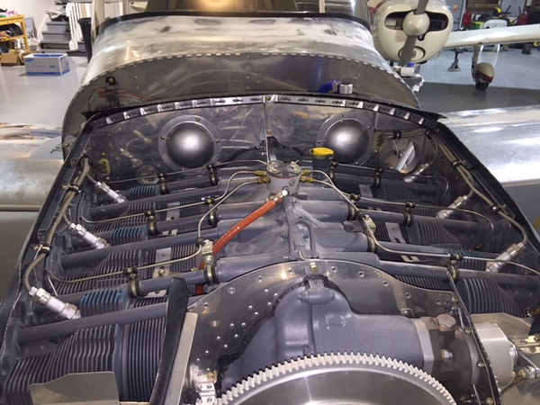

I just made some nice looking fiberglass covers for mine using 8 oz disposable food containers as plugs. The kind you get at the deli for stuff. Someone does make and sell them though.
az_gila 12-08-2019 11:56 AM
Aerosport has them ready made if you don't want to DIY fiberglas... :)
http://www.aerosportproducts.com/pro...-mount-covers/
vernon smith 12-08-2019 12:54 PM
Thanks, I'll order a pair.
Pdtofly 12-08-2019 02:22 PM
Hole plugs
http://rvbits.mybigcommerce.com/prod...T-COVERS..html
$40 for the set plus $15 fixed shipping from So Africa.
They will work on anyplane, not just RV-10?s.
Brian
RV10Pilot 12-08-2019 02:34 PM
I made my own out of fiberglass. Use a greek yogurt single serve container and clay to make the form.
alpinelakespilot2000 12-08-2019 03:39 PM
A piece of aluminum or stainless steel tape will work just fine. Just pull off annually for inspection and reapply.
Paddy 12-08-2019 07:23 PM
Engine Mount Covers
I hammered a pair of covers out of some 3003 half-hard sheet. Annealed twice during the work if I remember.
