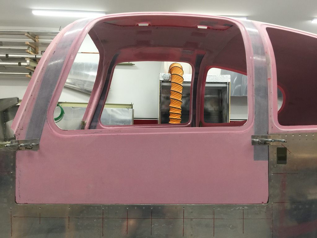

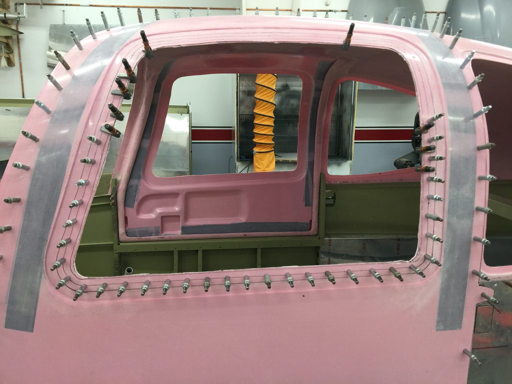

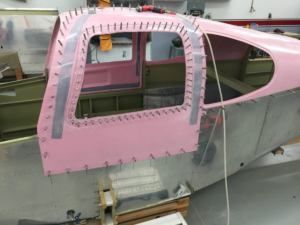

Bill Boyd 09-22-2019 07:09 AM
Trim generously. When ready, cleco the door halves in a few corner spots, center in door opening (look at it from the inside) attach door to outside of cabin with clecos. This is how you can position the door for adhesive cure when you glue the halves together - pinned to the outside of the cabin at the correct curvature. Use a release agent like packing tape so you don't epoxy your door permanently to the cabin top! Pinned in that position, use a hole finder to scribe the only additional cut line you will need. From then on use scrap aluminum gussets to hold door in its original location in the doorway, since you will trim away the flange and with it the positioning holes that the clecos went through before. Sand the edges of the door bit by bit until it falls into the doorway snugly like a tapered cork. There's a learning curve - the second one will go really fast :D

Bill Boyd 09-22-2019 07:23 AM
Pictures up!
Clecoed good and tight to the outside of the cabin
After trimming the flange, straps are used to keep the same alignment as when the edge finder was used to find the perfect scribe line. This is important for sanding down the door edges for a drop-in fit into the doorway without "creep."
