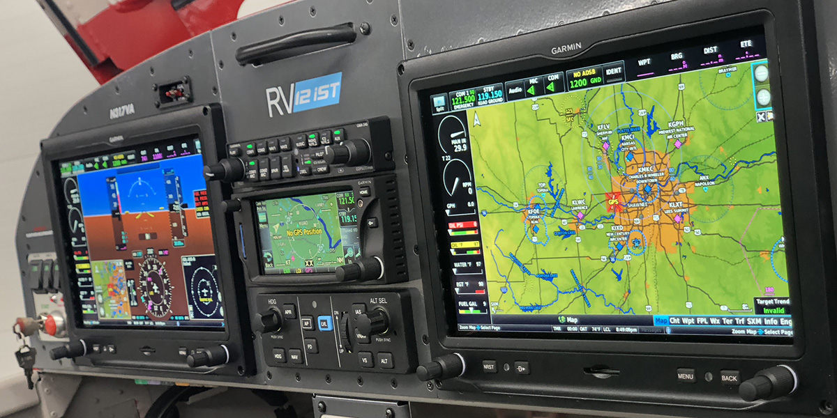

RV-12iS IFR Avionics Package Available for Orders
Van's has published the RV-12iS IFR avionics package order form and we are now accepting orders. This package is available for the RV-12iS only when equipped with the Rotax 912 iS engine, due to electrical capacity requirements.
The package includes:
Options include:
You can find the order form here. Note that the current Light Sport Aircraft standards (ELSA and SLSA) preclude operation in Instrument Meteorological Conditions (IMC). While aircraft licensed under the LSA standard may be operated "in the system" under Instrument Flight Rules, such as in a training environment, certification as LSA currently prohibits IMC operations. Also note that EAB-licensed aircraft are not restricted in this fashion. Lead times for RV-12iS avionics packages are currently as long as six months, due to order backlog. ![]() |
Looks good! Order already placed.
My thoughts on the offering: 1. A little pricey for the XM addition (+$615 in the regular package vs +$855 in the IFR package) (hurts. opted to go with XM only because adding it afterwards means a rip-n-replace of the GDL-50R with a GDL-52R). 2. Same thing for silk screen printing $600 vs $650.. (I didnt choose this option, price wasn't a factor) 3. Otherwise pricing was about what I expected, and the package is what has been advertised since last summer. 4. Thought maybe the GMC307 autopilot panel would be replaced with a GMC507 (see discussion here for the differences) 5. TO/GA button? Perhaps we'll be seeing those price increases in the regular RV-12iS package too. :-( Quote:
The price difference on the XM addition is actually related to the additional cost of a combined GPS/XM antenna that's used for the GTN650/XM receiver option. A single antenna that enables and connects to both units is used, and it just costs more. The VFR avionics package doesn't have the GTN radio, so it doesn't require the use of that special antenna. The prices for the silk screened panels are actually the same as in the VFR packages. The difference is based on the number of screens included by default in each package (and the panels costs related to that). The default price for the VFR packages accommodates one screen at $600, whereas the dual-screen option (which is the default selection in the IFR config) is $650 for the panels. You'll find the same prices for single- and dual-screen panel components are on the IFR and VFR packages. Glad you got your order in. It's a very nice setup. I enjoy flying it! |
Ahh got it. Didn't realize there was a silk-screen price difference between VFR (PFD only) and VFR (PFD & MFD).. makes sense. Ok you caught me on that one!
As for the XM stuff.. that makes some sense too.. I didn't even think about the antenna(s). Despite my list of gripes, I'm actually very excited about this -- since I started my build in Summer of '17, sooooo many options have become available.. most of which I happily integrated without having to undo/redo much. |

Just to expand on my prior posting, I'm starting to think the GTN650 will be a requirement for an IFR trainer. Even though the newer GPS navigators from Garmin are cheaper, if the intent of the RV-12 is to use as an IFR trainer, it sounds like the NAV radio will be a requirement. Better question for a CFII (hopefully someone here can give input), but a GPS only panel, although legal for IFR flight, would not let a student pilot working towards their instrument rating perform 3 different approaches. Better question, what is the minimum panel requirements required by a CFII for a student to earn his/her certificate for IFR?
The thread starter indicates a audio panel is included with this G3X IFR package, but the actual avionics order form does NOT list any. Pictures show a GMA 245. Nowhere is a audio panel or GMA 245 listed as included on that order form. Oversight? or has the audio panel been removed from the package?
Also, is the GTN650 now the enhanced Xi version? or still the previous version? Coming change maybe? Thanks Lance |
The audio panel supplied for the RV-12iS IFR avionics package is a GMA245 and the autopilot panel is the GMC307. I'll get our web order form updated to include the audio panel model info, looks like I inadvertently left that off.
I need to check on the GTN650 version status. Sorry, I just can't recall here on a Saturday. I will check on that and post again with the details next week when I'm back at work and can dig into that for ya. |
