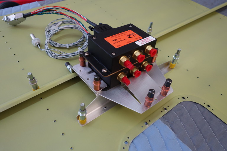

Has anyone successfully installed the RV-14 ADAHRS mounting bracket (W-00012) in a RV-10 with quick build wings?

I actually just ordered the parts to try this yesterday. They're not on "The List" yet but Rebecca @ Vans can process the order. I don't know for a fact that it's a drop in or whether the wing dihedral in the 10/14 is exactly the same, but it looks like a clever bracket/solution and for me with an A/C evaporator/blower in the tail the left wing location has some attraction.

I received the RV-14 ADAHRS bracket parts and assembled them. It's easy to do and they fit just fine in the RV-10 wing - can't comment on the operational aspects since I'm not flying yet.
Here's a picture, complete description and more pictures can be viewed here. ![]() |
