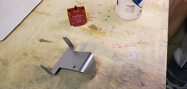

There seems to be a lot of information on how to mount these, no two are alike, and each method is a unique combination of benefit vs. compromise. Here's my take.
It starts with a new bracket made from a 12" x 12" sheet of 4130 purchased from McMaster. A hacksaw, files, and the dirt-cheap break from Harbor Freight was all it took to make this. The tapered shape and bends were made to exactly match the existing Lycoming bracket which mounts the fuel divider, and the bracket uses the same 1/4-20 bolt as its primary point of attachment. Opposite this bolt there are two tabs which, with the use of Adel clamps, provide additional support to the bracket by attaching to the push rod tubes. This is admittedly the compromise in this design, but great pains (and three different attempts) were taken to build this so there isn?t any load in tension or compression on the tubes.

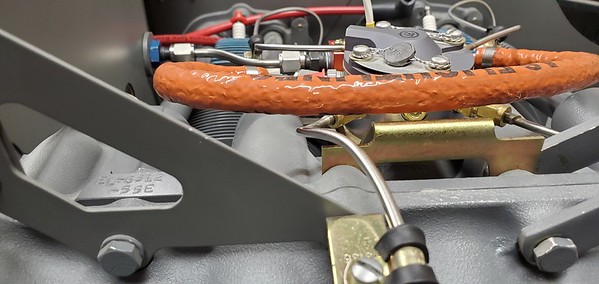

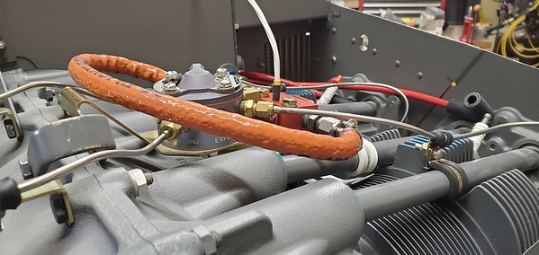

Two new fuel lines were necessary, made by the very capable hands of Tom Swearengen of TS Flightlines; one a stainless steel hard line running from a bulkhead fitting at the rear baffle to the transducer input, and one flexible/firesleeved line with 45? fittings running from the transducer output to the divider. On a side note, it?s been said many times and I?ll add to the chorus, Tom was a great guy to work with, his knowledge is unsurpassed, and he demonstrated a great amount of patience in dealing with a rooky like me.
The next two photos show the clearances of the new plumbing with the existing injector line plumbing. I?ll finish the install with an Adel clamp to secure the flex line to the divider bracket.
rvbuilder2002 07-04-2019 09:30 AM
Not what I would recommend. Adding a bunch of hose length above the engine will result in heating a bunch more fuel while parked. Engine starts after a quick turnaround could be more challenging.
rocketbob 07-04-2019 09:40 AM
In addition to Scott's comment you now have a loop at the highest point for vapor to accumulate.
Not going to work well.

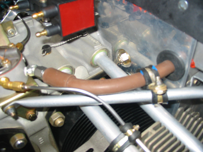

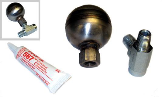

Old pic but this custom fitting is the best approach IMO.

Why is fuel inlet from rear of engine?, all the ones I?ve seen divider is clocked so inlet is in front which makes install easier with less plumbing

Just wanted to pass on another concern about penetrating the baffle with a hard line at that location. Unless well braced, that spot can be the source of significant vibration, especially if an oil cooler is hanging off the baffles. Mine is rock solid now, but I learned the hard way after cracking the oil cooler flange on the onboard side.

In defense----Chris had the 'unusual' plumbing of routing the servo hose to the aft baffle. At the same time, with all the flame wars about where and how to mount it, not mount it, plumb it, etc he had the unusual install of the flow divider being installed with the inlet port facing AFT.
YES we discussed the possibility of heat related issues after shutdown, and he was going to test things, and change if necessary. As everyone on VAF and others have seen, there is NO one one to do this. Everyone has an opinion, and all are right, no one is wrong. We tried for 8 years to get EI to tell us HOW THEY wanted the transducers mounted ( so we could develop a kit for that install), but their answer has been, "Its experimental, the builder can do whatever they want."
Also in defense, we've plumbed alot of these transducers, in alot of different places for ALOT of you. Some similar, some different. Yep, for some individual reasons, some were changed around. The fact of the matter is there is no recommended install location or plumbing. The RV14 IO390 FWF package as designed by VANS, has it between the mechanical pump and the servo mounted with an adel clamp on the #4 intake tube. I know of several OE install on certified planes where its mounted on top of the engine, with 2 hoses, so if its good enough for a certifed install, why not an experimental?
Chris did his homework and alot of research, and in his case came up with a plan. Yes he will try this out, and has accepted the fact that he maybe changing it around, IF it doesnt perform as it needs to. As for the transducer, yes the wires are UP---until he flies inverted--significant straight in/out of the cube---kinda per EI's recommdation. NO this install isnt in the finished stages, but getting there.
