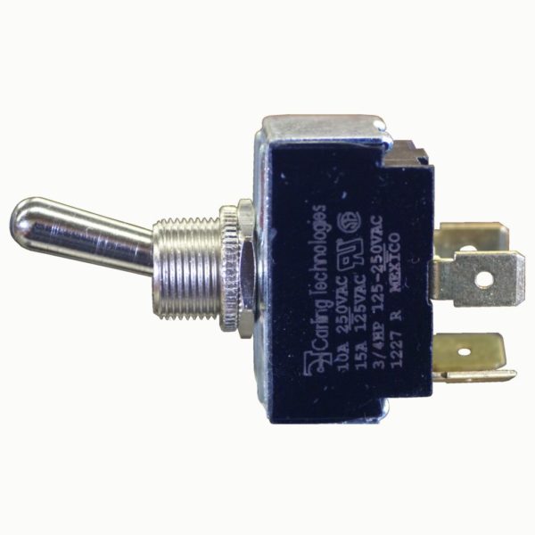

My Fuel Pump switch is a DPST toggle switch. The one circuit on there runs the idiot light, and the other pulls the VP-X circuit for the pump down to ground to turn it ON. Over the last couple of years I have had the switch occasionally not work to make the pump turn on. The idiot light on the panel will light up, but no sound from the pump. Using the VP-X menu on the Dynon EFIS you can alternatively get the pump turned on. If I get my hand behind the panel and wiggle the connectors back there, it will usually come back to life and work fine. I had every intention of swapping out the toggle switch at this annual, but when I was under the panel I realized that I only had a spare SPST switch, so I figured I'd do the swap at some other point later on.
Today, I went out for a quick flight and for the first time, the wiggling of the connector did pretty much nothing. I guess the switch finally is kaput! Thankfully, the VP-X menu can run the pump ON/OFF (but no idiot light when it is ON). Looks like an order to SteinAir is needed!
I'm just curious as to what the MTBF might be on this toggle switch. These are the good quality Carling switches from Stein, so I would have thought these would last forever.
Anyone else had a toggle switch go flaky at 660 hours?

They're good switches; you should be able to look up the MTBF specs on Carling's web site. Their biggest weakness seems to be using them with the old strobe systems, which apparently have surge currents *much* higher than their rated current.
Sounds like you're using one with virtually zero load current; sometimes, as strange as it may sound, no load can actually encourage corrosion on the contacts. But regardless, you having a failure doesn't mean that the MTBF is bad.
One last thing; have you verified that it's truly the switch, & not the crimp or the Faston?

If you got your hand behind the panel and wiggled the connectors back there and made it work, it sounds like you have a bad connection on your wire terminal, I don't expect the switch to be bad.

Like Charlie said, switches need a heavier load to burn away corrosion.
Switches that only carry low level signal current, should have gold plated contacts.
Switches that carry heavier current should have silver plated contacts.
Like people, switches need exercise. Exercising switches wears away corrosion.
Not using switches to make them last longer is counter productive.
Disuse will actually promote corrosion and failure.
Sometimes a failed switch can be revived by connecting a heavy load and
turning the switch on and off several times.

Do not use switches whose terminals use hollow attachment rivets! Stress and vibration will loosen the terminals, leading to switch failure and/or thermal runaway. I had 3 in-flight Carling switch failures: Strobes, Landing/Taxi lights and a Master switch. I replaced all cockpit switches with Honeywell 11TS or 12TS series solid rivet versions, with no further problems.
Use a small coiled service loop on the wires to decouple vibration, but secure the wires firmly in the bundle
Low current (signalling) switches should use Gold contacts. Power switching use Silver contacts.

Do not use switches whose current-carrying rivets go through plastic. That plastic will flow over time, loosening the rivets. That results in high resistance which makes heat and more resistance and more heat.

When I tore down my failed Carling switches I found the contact rocker had become banana-shaped from overheating. Loose rivets--overheating--looser rivets--more overheating--heat, smoke, failure.

Your switch is rated for alternating current (AC) only. Because the voltage level never crosses zero volts (sinusoidal wave) with DC current, arcing occurs each time the switch is thrown. This creates heat and eventually burns out the contacts. Find a switch that is rated for DC current. It will have much heavier contacts.
