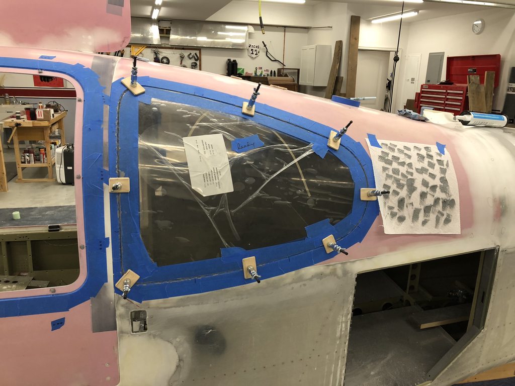

I used Sikaflex but the same process as the SilPruf method requiring no fiberglass work. I'm extremely pleased with the result thus far. I haven't painted yet, but the install and finished bead that will go on after paint results in a very nice look in my opinion. The install was rediculously easy as well.

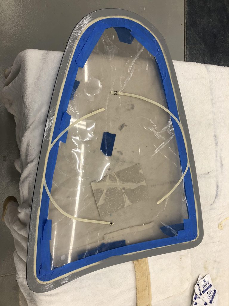

majuro15 03-09-2019 07:07 AM
Randy, I used the exact same method as the SilPruf that's documented on the YouTube series, except I used Sikaflex instead of the SilPruf. The Sikaflex is not silicone based and therefor (in theory, according to the MFR) can be painted over if desired. I mainly used it because it's UV and you can get it in black. I also wasn't as paranoid about cleanup since even residue of it won't affect future painting.
The primer for it is a bit expensive, but still not terrible compared to the cost of the build.
I'm just not great at fiberglass work and I did not want any chance of paint cracking down the road.

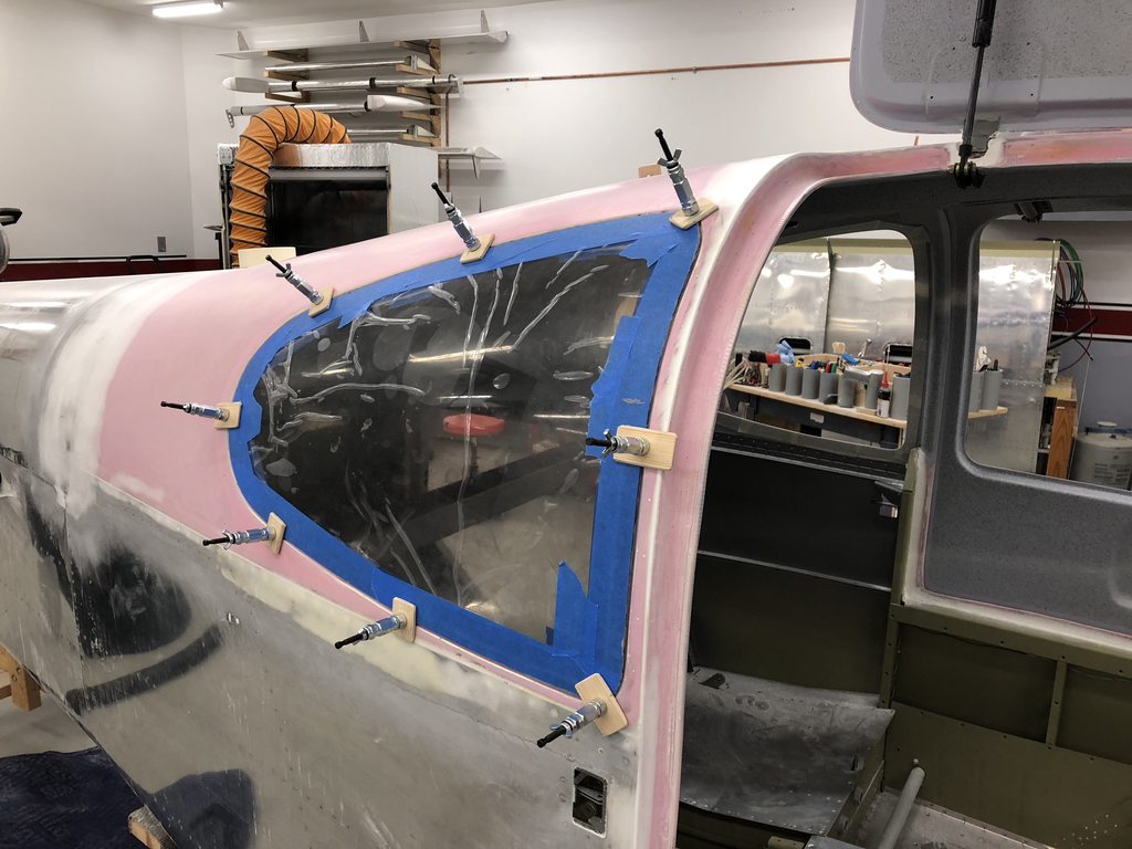

I used Sika on my -9A tip up. Lots of research and anxiety, but in the end it was a breeze. Couple of things to note - 1. I?m not flying yet, so... and 2. this stuff is messy. In my mind every bit as messy as pro seal. I didn?t tape off enough area and made quite a mess.
Working time with Sikaflex was not an issue, and glad to have avoided drilling the canopy.
