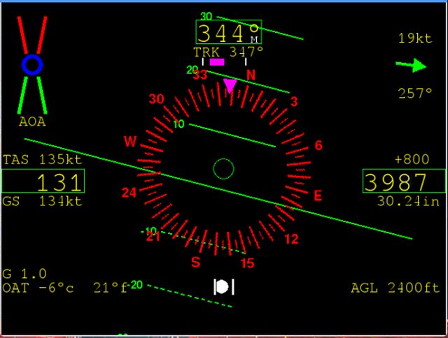

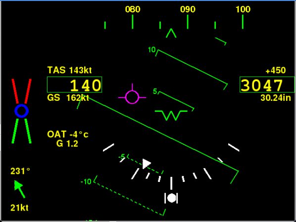

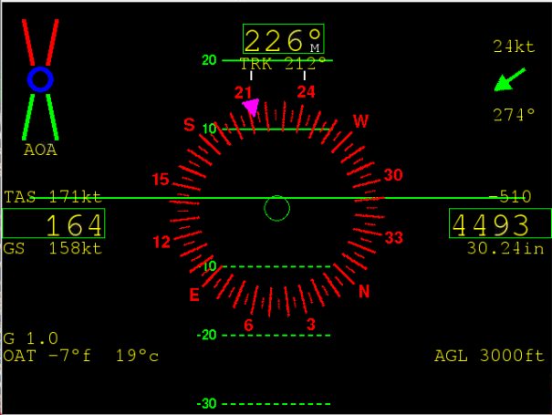

So a few of us geeks have been quietly working on a project that takes input from an EFIS (currently serial streams) and processes that data within a Raspberry Pi and generates an image that can be used on a HUD or other display that supports HDMI or CVBS (Composite) video inputs. (Think back seat display for tandem aircraft)
The project is being built with the ability to add different input modules and to make it relatively easy to add customized displays to the available options. Currently the serial input modules that have been developed include: MGL Skyview Legacy Dynon G3X Capabilities for each of these input modules vary due to the fact that the different manufacturer's serial streams also vary greatly in the variables being streamed. As would be expected, I have been working on the G3X input module and have developed the following custom display based on the data that is provided in the G3X serial stream. Several additional variables have been created by developing algorithms that use provided data to calculate those that are not present in the data stream. Here is a static image of the custom screen as it exist today: ![]() A video using data captured from a real flight here at about 3X realtime: https://www.youtube.com/watch?v=gzcrCiOq3uY&t=33s The flight included some steep turns, wing overs, rolls in both directions and general boring holes in the sky. Yes, this has been a distraction to my RV-10 build effort. I need to quit working on this and get back to work on that project! :p Mostly this has been a fun learning opportunity for me. I have never used Python or this type of graphical programming before. Thanks to Cecil "TRON" and his son Chris for getting this project started and all the foundational code work that has been done! Thanks to several others for the help along the way especially jacoby for his help! I am excited to see where this project might go in the near future. |

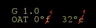

That display was tweaked today and apparently I fat fingered the units. Thanks for the catch! |

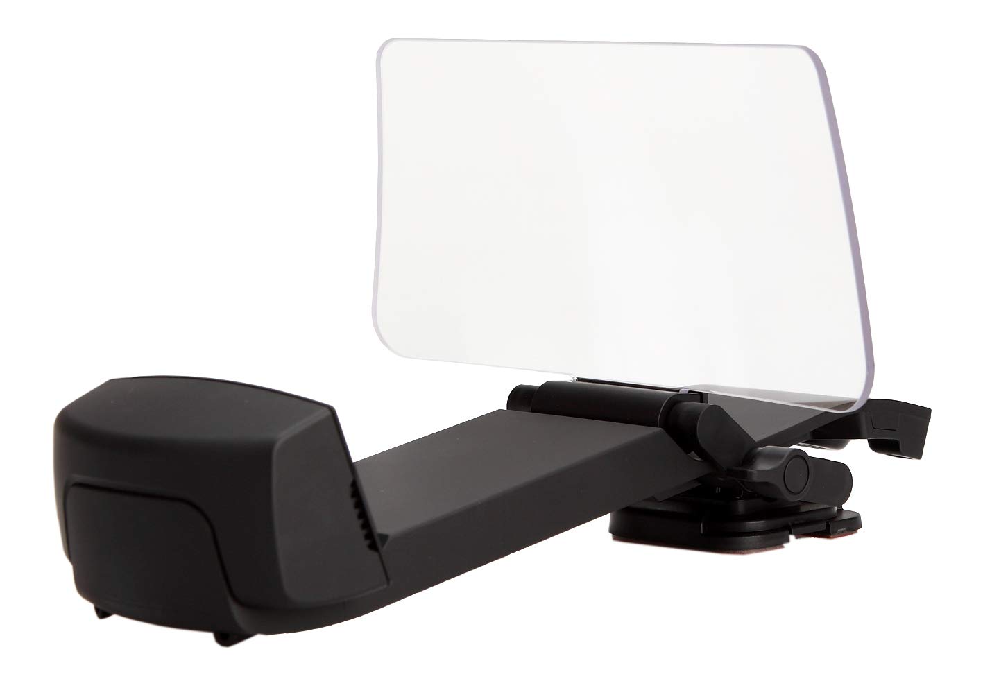

Really cool. I have been playing with a Hudly for a while in my RV and looking for something to drive displays that are aircraft oriented. Just thinking out loud on how i can take advantage of this in my RV.

I have fixed the transposed OAT units and have added a slip/skid indicator.

As far as I can tell the unsolved problem is a HUD display focused at infinity that does not requires a massive disruption of the instrument panel/glare shield, and which is visible at all Sun angles. Hudly is a step in the right direction but it's only focused a few feet from the prop and I think I read somewhere that it's not always easily seen at certain Sun angles.. |

The focus and visibility issue is real. I don't know all the details but it has been discussed. There doesn't seem to be a practical solution right now. You can choose between the ~$1k hudly or go off into the certified world and spend a magnitude more. |
