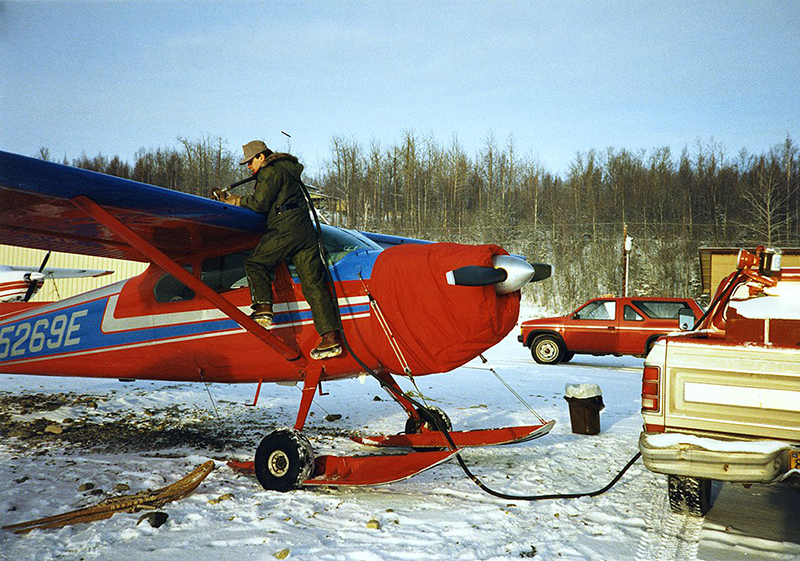

Back in the day, I had a 200gal tank in the back of my PU.
I used a 12v GasBoy pump with two particulate filters and a Go/No Go water filter. This set up worked great and I successfully pumped over 17,000 gallons of auto fuel into my C-180.
The pump rate was plenty fast and I never had a problem with contamination.
