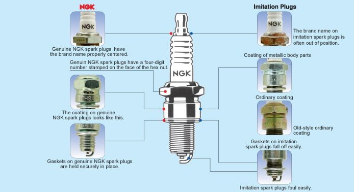

Counterfeit NGK spark plugs
While doing some research, I ran across this. You can bet I'll be checking my next batch of spark plugs.

Thanks for the heads up Bill. I generally buy these dozens at a time since all my airplanes have them; recently when doing the pre install ohm check, I found one that fell outside the generally very tight 4k reading I've come to expect. I set that one aside and continued on until I had my matched set of 12 for the Rocket. I went back and found 3 more that matched the one "off spec" unit... I'll have to see if I still have them and check for the counterfeit. Side by side they looked identical however.

I of course know the adage, too good to be true. BUT, on cheap auto plugs... I just never thought there would be enough money in the equation to make it worth it. Shows how naive I am. I throw mine away at annual and to date have not OHM checked them before install. I sure will now. And a close visual inspection for signs of counterfeiting.
