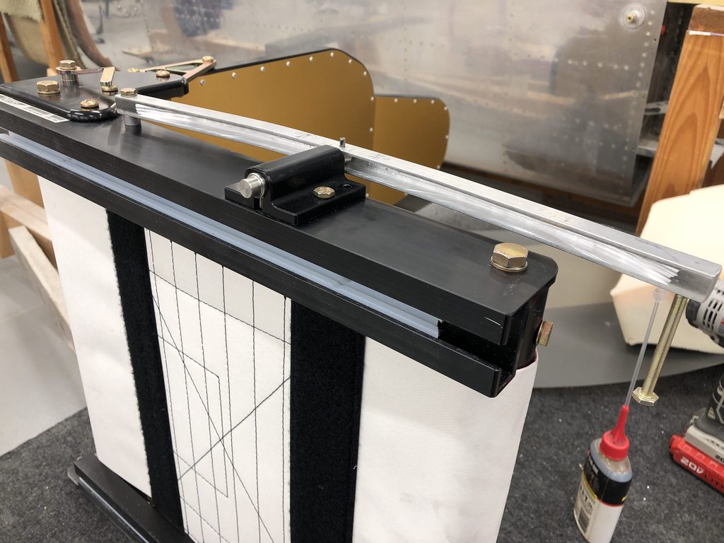

I installed Aerosport’s extended handle that lifts the factory latch, and made the seat rail modification commonly used.
I can remove the seat stop ( 2 an4 bolts), lift the latch, remove the seat aft off the rails and out of the cockpit in less than 5 minutes.
I’m assuming you’re talking abou r/r the seats, not the latches? I’ve never had to remove the latches since original installation.

Aerosport1 01-10-2019 08:48 PM
Just as Phil said very quick and easy to remove the 4, 3/8? bolts. Use a box wrench on the bolt head and 3/8? socket on the nuts. I also opened up the 4 holes about .007 or so and this really helped. My original holes had no play at all and if not perfect when putting back together was a little tougher

Electrogunner 01-11-2019 05:36 AM
Latches
Just drill and tap the latch. It's plenty thick enough. No nuts or nut plates required

Except that it's already drilled for AN3, so you'd have to replace the supplied bolts with AN4 and drill both the latch block and the seat to match. Frankly, I don't see the need. I swapped my latch locations to place them inboard and made the bevel in the nylon channel. From the opposite seat it is easy to lift the latch and remove the seat. The extensions would just make it easier, but I chose not to add them. For solo removal, so you have both hands free, make a spacer from some aluminum tube, cut one side out so the profile looking down the tube is a 'C' and slip it under the raised latch handle.
