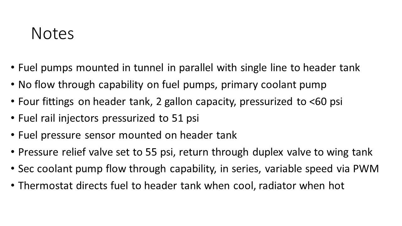

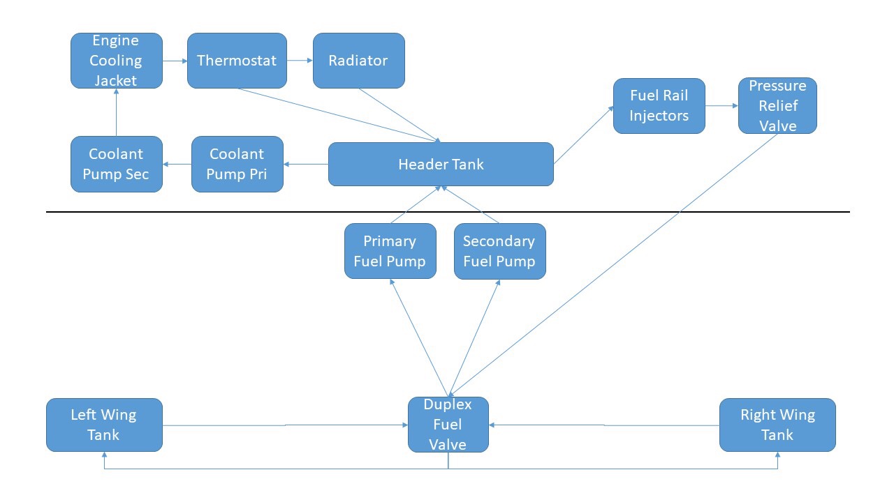

majuro15 02-14-2019 12:32 PM
We have finalized the fuel and cooling system layout which is pretty unique and pretty exciting. We really had to work at this to incorporate fuel as a coolant as Andy had envisioned. A comprimise was made to add a larger heat exchanger instead of only using the wings and tanks as heat exchangers, as there are times where the amount of fuel in the tanks just wouldn't provide enough heat dissapation needed.
So following our super scientific Power Point, the fuel will come from the selected wing tank through a filter in the wing root to the duplex fuel valve. Airflow Performance boost pumps plumbed in parrellel will push the fuel forward of the firewall into a 1.5-2 gallon non-vented header tank and pressurize the tank and lines to 51 psi. Located on the header tank will be a pressure sensor, coolant outlet and return fittings, and injector rail outlet fitting.
The pressurized tank will allow the entire fuel rail to be pressurized at the required 51 psi controlled by a pressure relief valve located after the rail. The relief port will return to the selected tank via the duplex fuel valve. The ECU will control the fuel boost pumps which will have internal overpressure protection as well. In the event of a pump failure, the ECU will automatically turn on the secondary pump and provide annunciation to the cockpit.
From the header tank will also be a coolant circuit. Airflow performance pumps will be variable speed and controlled by the ECU depending on engine temperature. The primary pump, plumbed in series with the secondary pump, will not have flow throug capability to assist in keeping the engine temperature optimum. The secondary pump will have flow through capability and will be activated by the ECU if the temperature rises beyond limits and/or the primary pump fails. After the engine cooling jacket, a thermostat will direct fuel either to return to the header tank or to a heat exchanger (radiator) to dissapate excess heat.
Once challenge that this solution takes care of is a requirement to heat the fuel prior to the injector rail to a minimum of 130 degrees F. This provides better combustion in the cylinders, keeping in mind that the Jet A combusts via spark, not compression. We did not want to have an inline, power zapping, electric heater for the fuel. While the engine will start and run fine on cold fuel, the optimum performance will be gained once the fuel is warm. Testing will determine if we will need to add an inline heater for cold weather ops prior to take off, but no heater will be needed in flight.
Our next area of focus is on the details of the electrical system/controls/ECU. We're planning a call with Andy early next week to get a production update and discuss the cockpit controls needed as well as ECU interface with avionics.

Not to question the experts here, but one immediate concern would be a leak in the coolant system eliminating pressure for the injectors. A cracked block or cracked exchanger/radiator could effectively stop fuel flow to the engine by allowing the pressure to bleed off. Is there some type of check valve on the coolant inlet from the header tank? I suppose the leak would have to be more than a small crack with two pumps operating.
Also, Is there any concern that that radiator cannot give up enough heat in ground ops? What happens during the OSH departure parade, where you are idling for 30 minutes at a dead stop in 100* ambients? To make the worst case worse, assume you started the engine already heat soaked. Don't know the boiling point for jet A, but being a multi fuel engine, this seems to be an issue running on gas, even at 50 PSI. Maybe an electric fan?
Disregard the second paragraph. I see that the pressure relief is on the fuel rail, eliminating that heat issue.
Larry
airguy 02-14-2019 01:02 PM
You say the primary coolant pump does not have flow-through capability - so if it fails how does the in-series secondary coolant pump continue to cool the engine?

Minor note...probably want good filtration between the header and fuel rail, given the circulation through block castings,

So, it appears the coolant pumps aren't redundant, so I would assume there is coolant temp sensor in the block somewhere to indicate proper operation. What is the procedure if that primary pump fails and coolant stops flowing?

PWM on brush type DC motors could be a bad idea. Others have noted a serious reduction in pump life and some pumps plain don't like it and don't respond well at low duty cycles. Better test that thoroughly on the bench before getting married to the idea in the airframe.
Complicated system, lots of places for something to go wrong.
If you want to warm the fuel, a simple tubing loop in the coolant would do the trick. You won't be able to sink much heat into the fuel for long at high power with that small header tank capacity.

majuro15 02-15-2019 08:28 AM
Larry, great point and question. Yes, there is a risk on having a cooling leak which would cause a drop in fuel pressure. We'll have to take a deepr look at that and mitigate risks. Initially, I'm thinking of keeping lines as short as possible, using quality lines and fittings, and layingout the air supply to minimize the impact of FOD damaging the heat exchanger if that's possible. It does bring up another concern that any leak or damage has the risk of creating a fire as well. We're looking at the potential for that to happen and evaluating the risk, as there are some common risks to other engine setups for fuel fires, just not as much as on this setup.
We will have the option to do a fan on the heat exchanger for ground ops. I plan to incorporate that into the cooling plenum design for the heat exchanger. The fan can be run by the ECUs just like in a car.

Greg, excellent point, thanks for noticing that. As drawn out, I was thinking of a failure of the motor but still allowing fuel to go through it, but that's not right. I've changed it to a parallel setup and have no flow through either pump to retain flow rates that we need. This will mimic the fuel pump setup allowing redundancy. Good catch.

Ross, Don at Airflow said the PWM isn't a concern at all. I don't know all the technical details but he didn't anticipate any issues or longevity concerns with his pumps and variable speed.
We looked at a liquid to liquid heat exchanger for warming the fuel, but the most increase you can get is about 40F, not enough to get to the 130F. We're trying to avoid electric heaters since they pull so much power which could impact operations with a limited electrical system capability.

That's good that Don's pumps work with PWM. Are these an impeller pump? Brush or brushless motors?
Should be able to get a lot more than 40F rise with oil or coolant to fuel HX. Commonly done on older GA turbine stuff.

I played with this idea (fuel as coolant) quite a bit during my early building phase when it was looking like the Deltahawk might actually happen and I was drinking the Koolaid. You're right in that you'll need an air-to-fuel exchanger for at least part of the time, but you may be surprised how much heat you can dump in the wing if you'll take a couple things into consideration.
I was looking at a low-pressure header tank, with the pressurized fuel pumps pulling out of the header tank to the engine. The fuel/coolant in the header tank was only going to be about 10 psi and the flow rate was fairly high, displacing a lot of it through the header tank (which would have a coolant loop through the engine) back to the wing tank through a duplex valve, and with the return line going all the way to the far outboard bay of the wing tank. This forced the returned hot fuel to flow through the tank all the way back to the inlet and wet the entire tank surface to the fuel temp, providing a pretty decent heat sink, even with low fuel levels. You'll still need some additional air cooling though - but it's reduced. Your design is using the fuel pumps themselves to produce the flow through the header - you might want to put the fuel pumps AFTER the header, and use high-flow low-pressure boost pumps to move more fuel through that header and back to the tanks for thermal transfer.
rv6ejguy 02-15-2019 10:28 AM
You can sink a fair amount of heat into the full load of fuel on an RV but not a 2 gallon header tank with no recirculation to the mains.
Figure around 50-60,000 watts are being dissipated into the coolant at cruise power on a 300hp engine.
majuro15 02-15-2019 10:46 AM
Ross, I believe they are brushed pumps. I'll have to check my notes from Don, as I can't remember off the top of my head.
Greg, so we are right there with you on some aspects. That was how we originally thought we'd dissapate the engine heat but to Ross' point, when you get down to 5-6 gallons of fuel left in a tank (which is a reality with an hour reserve fuel left on board), you run out of surface area in the tank to bleed the heat. Then it becomes a question of how to decide where the fuel goes based on heat, wing first then up through the system then to HX first or to small HX then to wing, etc. What we are afraid of is getting to a low tank level and running out of options to get rid of the heat.
So we played with the idea of a lift pump and then a boost pump from the header tank. That's still on the table as option B. I haven't gotten a 100% confirmation the cooling jacket of the engine will withstand 51 psi, so the pressurized header tank may or may not work. Our thought behind it was eliminating complexity with a need for four fuel pumps (two lift, two boost). But yes, we have a design setup with two lift pumps to the header tank, then using boost pumps for the fuel rail and cirulation pumps for the cooling cirtuit.
Ross, do you have any pics or designs for a HX? I'm only finding some diesel truck stuff at this point before trying to roll my own as a test.
