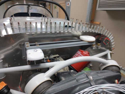

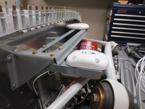

I installed my Dynon and Garmin under the cowl and have over 12" between them. I believe that it was in the Garmin manual that stated it needed at least 12" between GPS pucks.
I should be able to get the oil filter off with the GPS as they are. If I need a little more room, the GPS rack comes off with the removal of the 4 screws.
http://www.kitlog.com/photos/project...2017A00018.jpg
jwilbur 11-20-2018 08:08 AM
Personally, I wouldn't put them here. The distance between them may be fine but the airplane itself will shadow any signal coming from the rear. In other words, a satellite signal from the back will be invisible. For travel on the ground all we need are a few satellites in view to get a good 2D location fix. In the air we want as many satellites in view as possible in order to get a 3D location. And the further apart those satellites are from each other the better the 3D fix. That means satellites overhead along with satellites at low angles (closer to the horizon) together give us the best position in 3 dimensional space. In this location any satellites behind the aircraft are useless. ... This is essentially why in an aircraft we use external GPS antennas at all. In your car we don't care. Any position fix is typically good enough. Not so in an airplane.
I would recommend moving them - particularly if you intend to do GPS LPV approaches.
