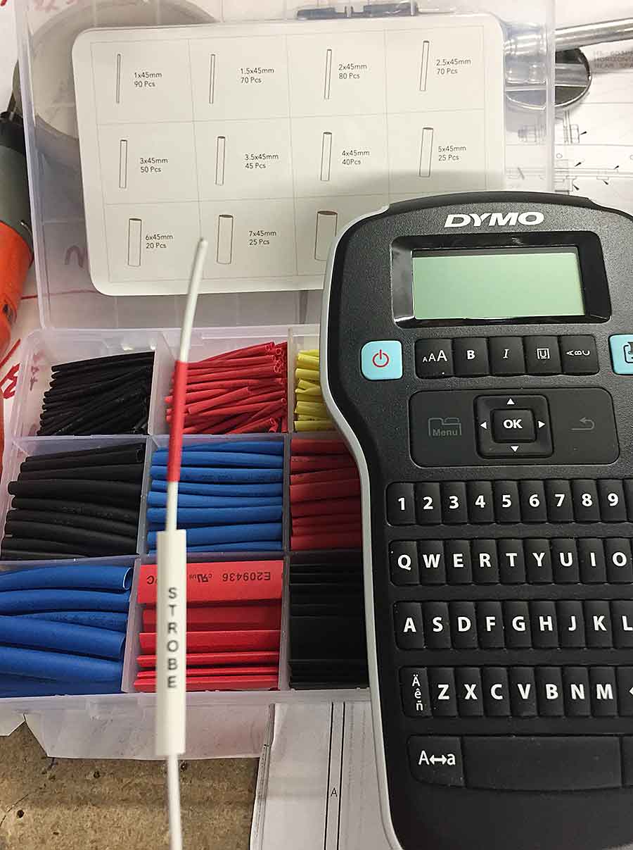

Thanks for all your input. I bought a Dymo LabelManager 160 for 20 bucks on Amazon, and 1/4? heat shrink label tubes. I was concerned that the 1/4? tubes would be too big for 20 gauge wire but it works perfectly.
Has anyone been able to find printable tubing in something smaller than 1/4?? Most all of the wiring I plan to install is 22 gauge.
I think I?ve found one printer for nearly $300 that has something less than 1/4? tubing available, but the tubing is something like $40 for a 3 foot length. I?ve used laser printer labels with clear heatshrink in the past, but I really like the look of the printed heatshrink. Thanks in advance! |

The 1/4" tubing will do 22 gauge wire. I'm amazed at how much it will shrink. Here's how it looks... sorry about the spelling :D ![]() |

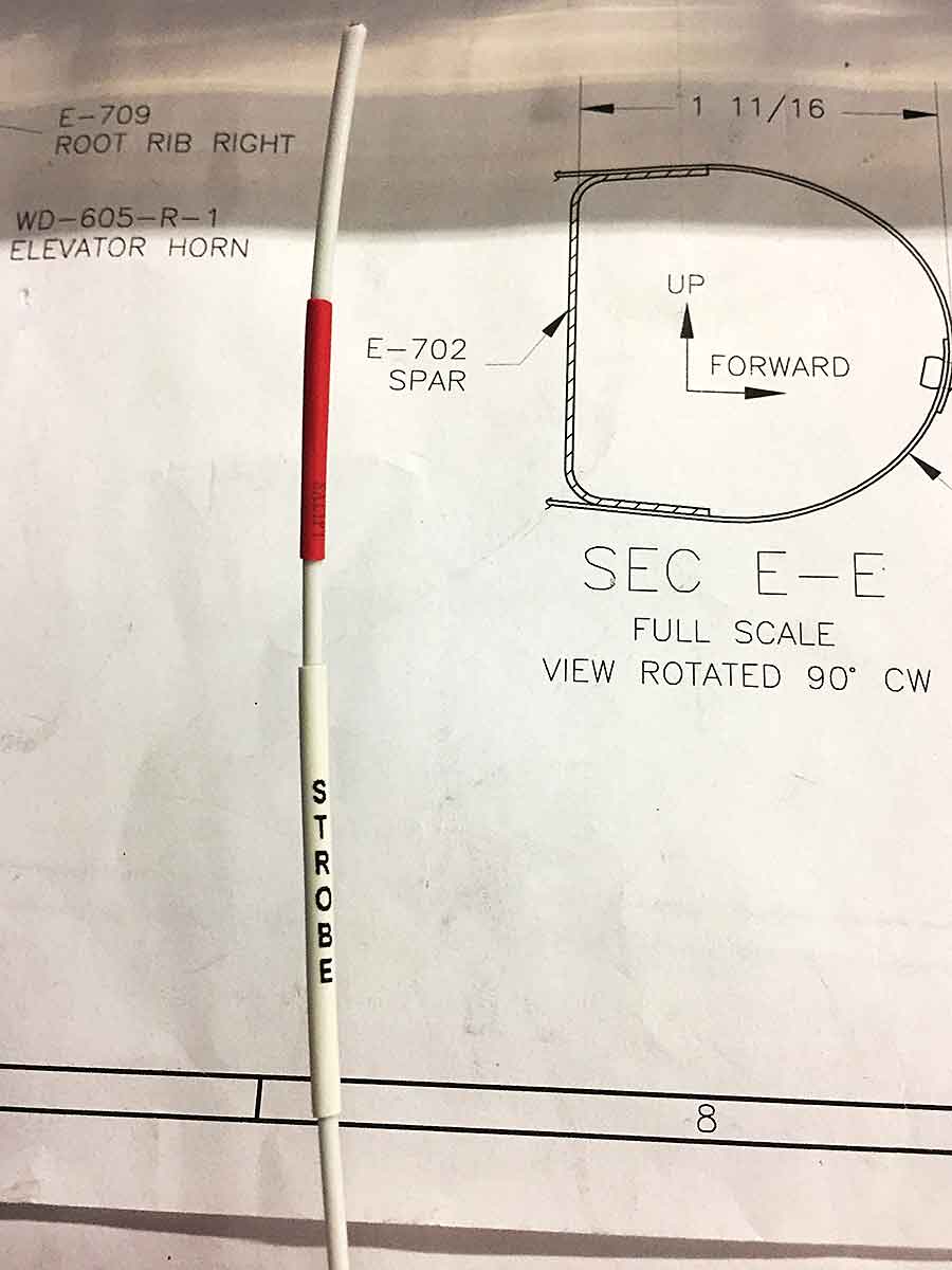

I started this thread because I was seeking input on people's experience with various methods of labeling wires (thank you all), and then I updated it in post #44 with what I found to work very well for a very economical cost ($20). I'll reiterate the Dymo Label Manager 160 has been working magnificently using 1/4" heat shrink tubing ($22 for 3 x 5' of tube) on wire gauges ranging from #8 to #22. I couldn't be more pleased with the results.
I decided to expand on this idea. So I already had this particular Dymo label maker so I thought I would see if the ?" shrink tube labels would really work in this label maker. They do :D While I was rooting around on Amazon looking for the heat shrink tube labels, I had the idea of buying some colored heat shrink tubes as well. Here's the system I'm going with: Positioned but not shrunk yet. ![]() All shrunk up.... Labeled and color coded in one easy step. ![]() Here's a link to the colored heat shrink tubes. Here's a link to the heat shrink tube labels that work in the above label maker. |
The 1/4" tube may be fine for one or just a few wires, but it's way too narrow for a Dynon network cable. I have 12 mm and 9 mm on order and one of those should work ok.
