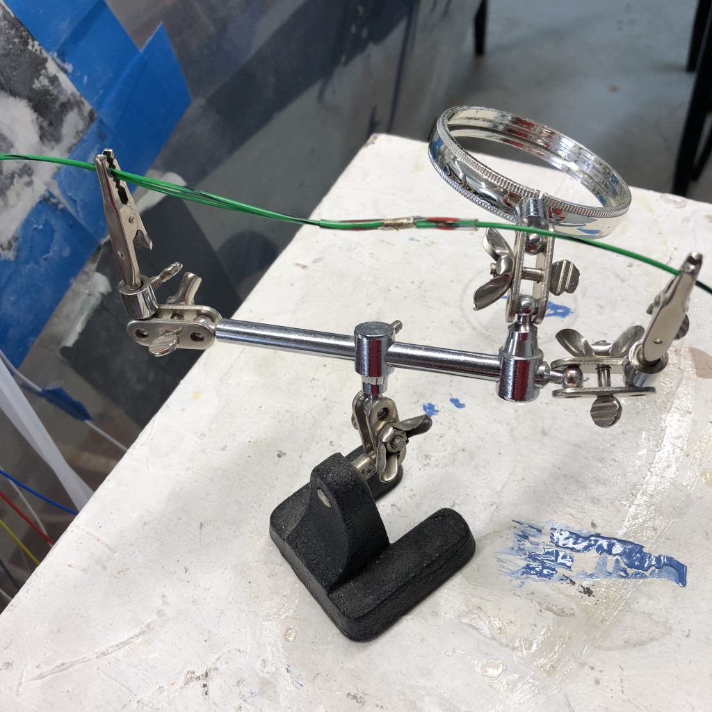

Hi Larry,
I find they come in 4 colours:
White are very thin and useful for joining 2 thin wires (AWG 24 to 20)
Red are bigger and for joining 2 thicker wires (20 AWG to 14 AWG)
Blue I use for joining shielding wires in 2 / 3 / 4 cables
Yellow are too large for most things but occasionally I use them when I have lots of wires bunched together
I would get blue ones for shielding and reds for general purpose wire joining.
Happy soldering !!
Amer
