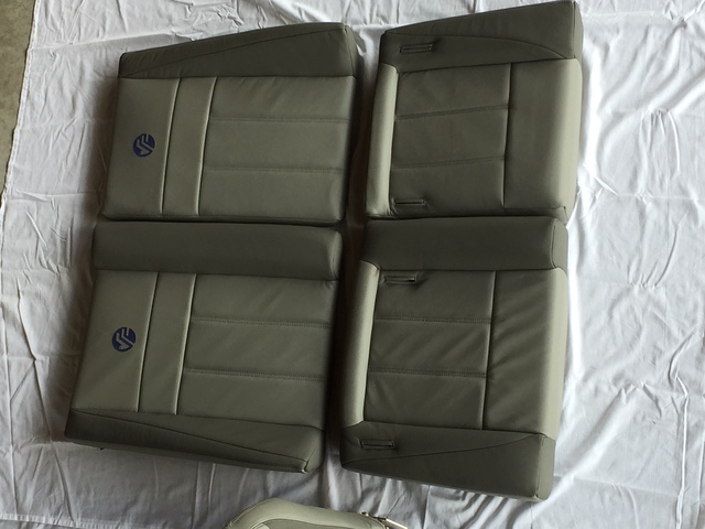

woxofswa 09-05-2018 01:20 AM
This was done by Abby at Flightline and we love it, but I?ve heard she doesn?t do RV10 kits anymore.

Not totally true. She does not do side panels for the R10 anymore. Flightline will still do RV-10 seats and carpet.
It would not be difficult to roll your own modification for a rear bench seat. Either a middle insert, 60/40 split seat or a full back. Use the same construction technique in the plans and extend one of the sides or make a small insert section and attach it to floor with a piano hinge.
