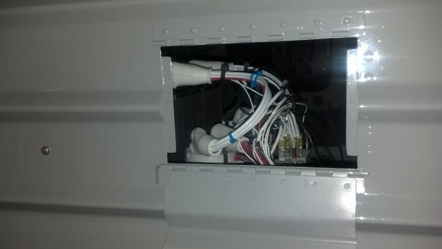

Need advice from fellow builders who have been down this path before me.
Working on rear bulkhead panels now. Seems like you'd want to look into tail cone once in a while just to see how things are (between condition inspections). Some builders have added an access panel. See link to this thread:
http://www.vansairforce.com/communit...d.php?t=114894
Is it worth adding an access panel? I'm thinking just large enough to have a good look once in a while without having to remove the entire lower panel. But, is removing the lower panel any big deal? Don't want to overcomplicate things and anytime I deviate from plans, it takes time.
Thanks in advance for your insights.

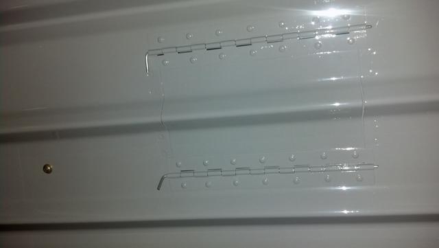

I put in small door (some hinge material on top and bottom, some scrap pieces - done). Pull one pin and the door opens. I use it all the time. I have a ground DC power supply connection behind the door to run the panel if needed. A flashlight look through the door once in a while to make sure all is well.
I never take off the top panel. The bottom only comes off for condition inspection.
Carl

It?s easy enough to get the panels off and there are few reasons to look back there between annuals.
But more importantly, that bulkhead is structurally important. I have a problem with amatures making modifications without any knowledge of engineering. There are quite a few 10s out there that I would fail a pre-buy inspection because they were structurally modified and made unsafe.

rvanstory 06-17-2018 07:15 PM
Thanks for insights! I was on the fence. Now I'm not. Build on as per plans.

Carl Froehlich 06-18-2018 07:08 AM
To each his own, but adding this proved well worth the time.
Carl
