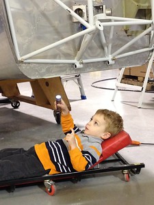

I'm right at 3 years into finishing a second hand kit I picked up at more or less quick-build status. Right now, I'm in fiberglass finishing **** (which is different than cabin top **** or door ****), and am weary of the fiberglass work. Because of this, I've been slacking on the project for the last couple of weeks. I figure I have a hundred, maybe a hundred fifty hours of work before the entire project goes to the airport for paint (pro painter friend has a shop on my home field) and final assembly.
Regarding kids and help, my son was 4 1/2 when I started the project and is (do the math) 7 1/2 now. He's curious about the project, but is absolutely no help other than "hold this for a minute" or allowing him to drill a couple of holes. He just doesn't get much from the build process and his ability at this point means he has to be watched like a hawk or 5 minutes of his help will turn into 2 hours of rework. :-0
So, I do most of my work after he goes to bed in the evening.
