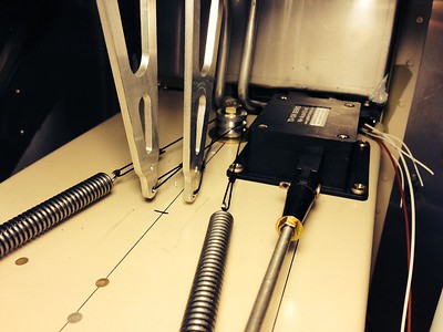

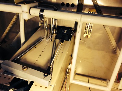

RV-10 rudder trim ideas
I ordered the Aerosport under-panel rudder trim kit and spent this past weekend attempting to install it. I finally gave up - it's waaaayy too busy under that panel for that mechanism to peacefully coexist with everything that's currently there.
I definitely need some sort of rudder trim and I want it to look at least a little bit thought out (as opposed to a bendable tab slapped on the rudder trailing edge). I thought briefly about attaching the springs that came with the Aerosport kit directly to the rudder cables somewhere in the tail section, but that could create more problems than it fixes.
So I'm mining the community for ideas.

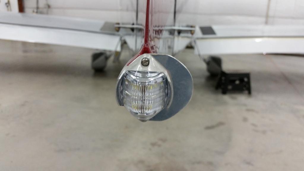

I just described a rudder trim tab that I made, which requires no special attachment. I cut a piece of scrap to match the tail light mount on the right side, and left most of it squared off on the left side. Then bent a relatively large radius bend to put the protruding part at oh, perhaps 20 degrees less than right angle to the rear. Drilled holes to fit tail light screws and slotted on right side for tail light wiring. Amazingly enough, my first attempt at the angle proved to be absolutely correct for no rudder input in straight and level.
The force needed for climb or descent is so little, I can't imagine having an adjustable trim that is only needed for perhaps 10 min at each end of flight if you go up fairly high.

JackinMichigan 06-05-2018 08:50 AM
Originally Posted by AviatorJ (Post 1264902)
Doh, this was going to be my solution. Is it because there are items such as wiring, mounted items ect that interfere with the kit?
Yes. I was originally going to mount it on the co-pilot side, but that's where my radio stack and Garmin GTN-750 is. The structure built into the panel to support all that makes it near-impossible without significant structural reworking, and I wasn't about to do that laying on my back over the seat hump with a Dremel tool.
The pilot side is the same story, that's where all the computer 'guts' are. I would have to remount a couple units deep in the bowels of the panel layout to make it happen.
That being said, you might have better luck. I'll sell you mine for cheap.
Carl Froehlich 06-05-2018 08:50 AM
I did the same. Simple to do and no lasting damage if you don?t like it.

rocketman1988 06-05-2018 08:51 AM
Rudder trim
I have the aerosport rudder trim and have no issues with room to install it...
Carl Froehlich 06-05-2018 11:58 AM
Here is the simple trim tab I mentioned in my earlier post. Not my idea - I stole it. Hard to see, but the tab is bent aft perhaps 30 degrees.
Carl
