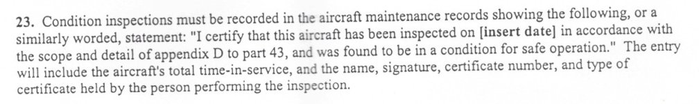

The FAA uses these words, as snipped from my previous post - ...Requires the maintenance record entry... How you do "maintenance records" (FAA wording) is up to you. Log books are convenient, but if you have a detailed builders log... I started my actual log books at the time of final FAA inspection. |
I was told by an A&P, although I have not confirmed it, that you should include your airman certificate number and signature with the logbook entry...
Be sure to apply for your limited repairman certificate when you?re done, so you can sign off the condition inspection. |
