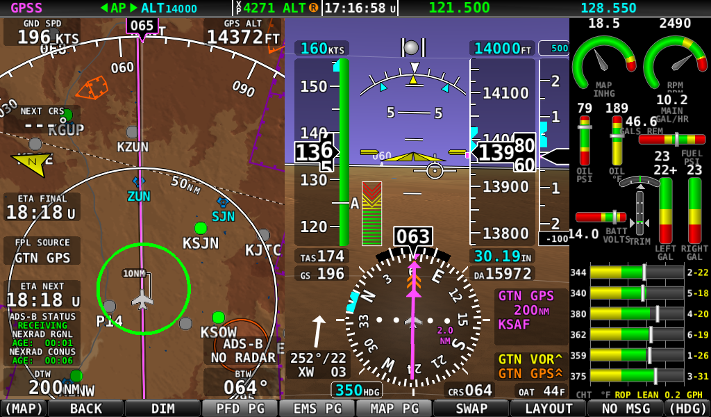

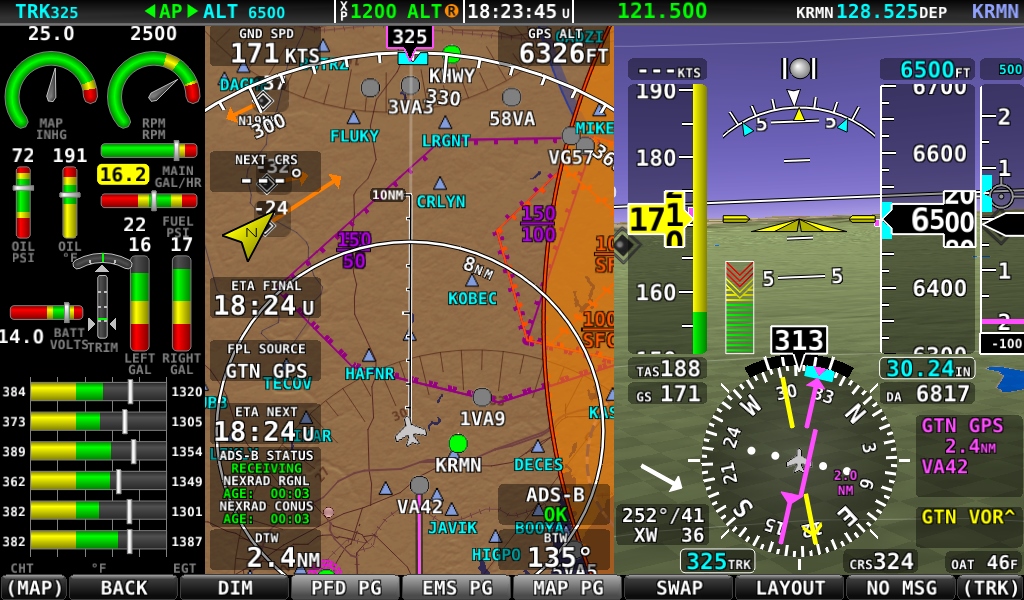

I built using the James Cowl, Plenum and Wheel Pants. This added time to the build but I'm happy with the performance (a couple of screen shots attached). The plane has a stock engine and prop from Van's.
James Cowl no longer offers the cowl for the RV-10, but you can still get the wheel pants. They have a smaller frontal area than the stock Van's pants but again add a little time to the build.
Don't underestimate the value of rigging. Rigging is more than just wings level and the ball in the middle.
Carl

Carl, that is way faster than Vans numbers, have you checked your TAS vs flying a GPS box to verify static error?
If the static is pretty close you have one slick machine! :eek:
Carl Froehlich 04-13-2018 04:02 PM
My checks show TAS readout is about right. There is no magic here. The cowl/plenum setup has less cooling air coming into the engine, so less drag. The plenum uses the cooling air about as effectively as possible. I do offer that there is a trade off. I find cooling is fine for how I fly. It would not be adequate if you want to do a 100kt climb to 10K?. I climb at 130kts to keep the engine cool.
Carl
