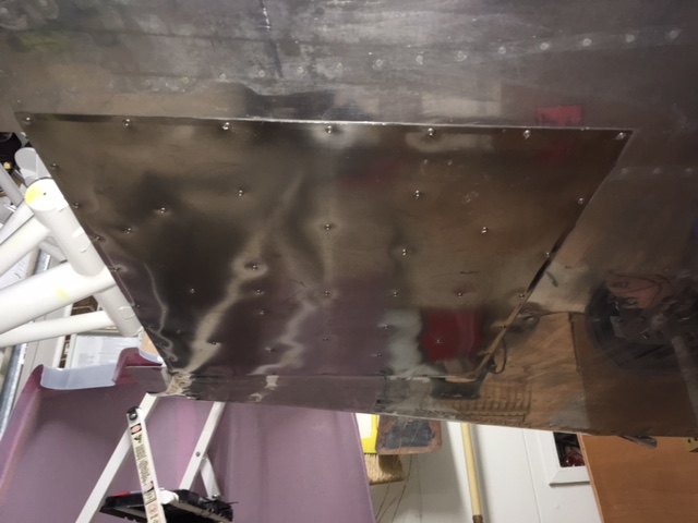

I've been reading through many of the posts. Those of you who followed Dan Horton's method of insulating the firewall, how did you insulate the tunnel and/or belly? Did you insulate the belly on the outside?
Kyle Boatright 03-11-2018 09:29 PM
I have a 24"x24" piece of stainless on the belly. I rolled the edges, placed a 1/16" fiberfrax blanket under it, sealed the edges with pro seal, and pop riveted it in place with stainless pop rivets.

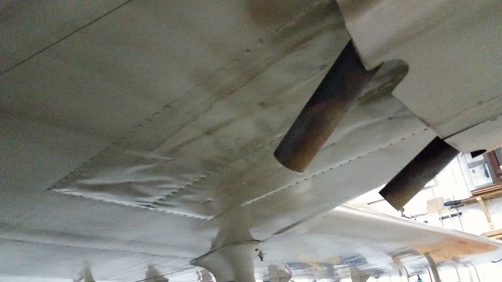

ppilotmike 03-12-2018 10:16 AM
Belly Shield
I did install a belly shield too, using 0.010" SS sheet, which is plenty thick (i.e. it behaves like sheet stock, not foil). Using 1/16" Fiberfrax and securing with rivets and Fire Barrier 2000, the total assembly turned out to be fairly flat and well transitioned. I primed the aluminum skin underneath the belly shield too. See picture on my builder's log below.
http://www.mykitlog.com/users/displa...=222385&row=99
There wasn't much pillowing at all, and I assume that, after final paint, it will all but disappear. After seeing pictures of the RV-10 that had a fire event, with the gapping hole through the belly into the tunnel, I figured it was good insurance. Additionally, shielding the firewall and belly should keep tunnel heat down too; an added bonus. My $0.02.

ppilotmike 03-12-2018 03:06 PM
My belly shield does, in fact, use the rivets that attach the ribs to the bottom skin. I used rivets slightly longer than the ones called for by the plans, in order to get the proper diameter/height on the shop head.
Keep in mind, that 1) my belly shield is not the full length of the bottom skin, only the first 18 inches or so, 2) the Fiberfrax crushes a little at the point of attachment, leaving very little thickness at the rivet lines and 3) the SS sheet would add a bit of tensile capacity to the bottom skin.
It would probably have been better to use separate/extra rivets to secure the SS sheet/FF to the belly (I thought of that for my firewall), but, for my small belly shield, I didn't do it that way.

Kyle Boatright 03-12-2018 09:19 PM
Originally Posted by jeffwhip (Post 1245520)
Dan,
Do you have any pictures of what that looks like?
Jeff
Here you go (I think)...
jeffwhip 03-17-2018 04:33 PM
Thanks! That's what I'm looking for.

I purchased a 24"x48" sheet from either Grainger or McMaster Carr. I don't remember which (I was shopping on delivered price). Off-hand, I don't remember which alloy I used, either. I used half of the sheet on the belly and half of the sheet on the bottom center of the firewall.
The 0.008 didn't pillow and was easy to cut with snips and drill with regular bits.
