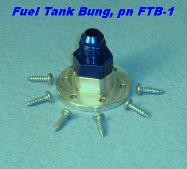

Now, the return line fitting. Someone from this forum pointed me to the following site for an outside flange Bung that would not require a large access hole cut in the baffle. https://www.flyefii.com/products/acc...uel-tank-bung/ I could just drill the hole for the fitting and rivet holes, clean out the shavings that may gather inside the tank when drilling and then install with proseal and closed end rivets, (not the screws in the picture).
Then the last thing to do is proseal and screw the fuel sender in place.
