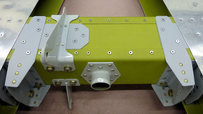

alexe 02-19-2018 11:37 AM
Scott,
Regarding the stabilator SB, does the HS-01231C gusset (figure 4) fit beneath the skin or on top?
Alex
DonFromTX 02-19-2018 01:49 PM
I too am having some difficulty visualizing all this from the drawings.
Photos from the first people will be valuable.
Originally Posted by alexe (Post 1240662)
Scott,
Alex
joedallas 02-19-2018 02:00 PM
Scott
Figure shows the patch on the top adding as shear connection to the hinge bracket , in my view
Joe Dallas
Scott,
Alex
Mel 02-19-2018 02:01 PM
Scott,
Alex
My interpretation is that both figure 4 and figure 8 clearly show the gusset to be on top of the skin. Also Step 27 states that no spacer is needed under the 2 inboard, aft rivets. If the gusset were to be under the skin, that statement would not be necessary.
rvbuilder2002 02-19-2018 02:32 PM
Mel is correct.
rvbuilder2002 02-19-2018 02:37 PM
Originally Posted by joedallas (Post 1240690)
Scott
Joe Dallas
Since you weren't using part numbers I assumed you were talking about the doubler (patch) that goes over cracks on the antiservo tab (a different S.B.)
The doubler on the top and bottom of the stabilator is an important component for longevity and crack avoidance.
Call it a patch if you want, but it is a doubler.... just like all of the triangular doublers that are on the exterior of the fuselage belly.
