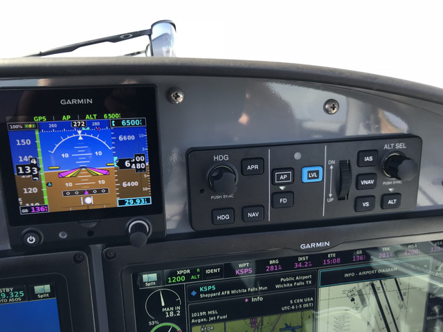

Jeff A 02-09-2018 09:52 PM
GMC307
One question regarding the new software...is there any chance that it impacted the GMC307 in some way? Upon initial AP engagement, no mode chevrons appeared on the GMC. Disengaged and re-engaged, and only two (no AP or NAV) chevrons appeared. Disengaged and re-engaged again, and all appropriate chevrons illuminated. Only thought to snap a picture at the second instance. I didn't notice any other issues through the remainder of the flight, but also flew quite a bit without the autopilot engaged.

g3xpert 02-10-2018 08:03 AM
Hello Jeff,
We will certainly look into this, but we confirmed that the GMC 307 worked correctly when we were testing the V5.70 software.
When you go into configuration mode and select the GMC 307 on the System Information page, there is a touch screen button to test the annunciator lights on the GMC 307, but it sounds like they are functional.
Steve
