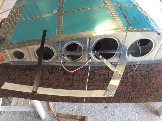

Here is a nav antenna I made for a new RV-14A. The overall tail length is long as the photo was taken before it was shorten during the tuning process. The black tape was use to temporarily hold it in place while tuning.
Carl ![]() |
Thank you for the quick response and the photo. This looks like it would be a good solution in my RV-14A wing. Does the antenna just slump down in the wingtip, since it looks like it is attached to the rib about in the middle? How is it attached? I have no way to measure antenna performance. I purchased my antenna from ACS. Would it be ok to just leave it full size, rather than shortening a leg?
I make these antenna, so the reason for tuning.
If you are just buying the Archer antenna, don't change it. Carl |
