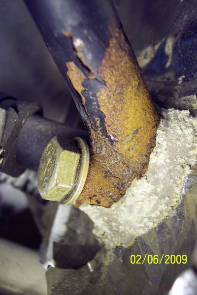

snopercod 01-20-2018 06:39 AM
You have to be careful choosing a fire barrier caulk. On my Lancair I used the stuff that came with my Firewall 2000 Ceramic Blanket kit - 3M, I think. Over the years, it ate into my engine mounts.
DanH 01-20-2018 07:32 AM
John, can you identify the sealant?
snopercod 01-20-2018 03:10 PM
I'm afraid not. I threw the tube out over twenty years ago. Here's what it did to my engine mount, though:
I wire brushed it down to bare metal, determined that the damage was superficial only, primed it with red oxide primer, and top coated it.
DanH 01-21-2018 07:02 AM
Hmmm. I suspect latex sealant, or one of the acid cure silicones, but I'll have my cowl off today for a condition inspection in progress. I'll take a hard look at the FireBarrier 2000, now going on 9 years since installation, in a humid deep south climate.
