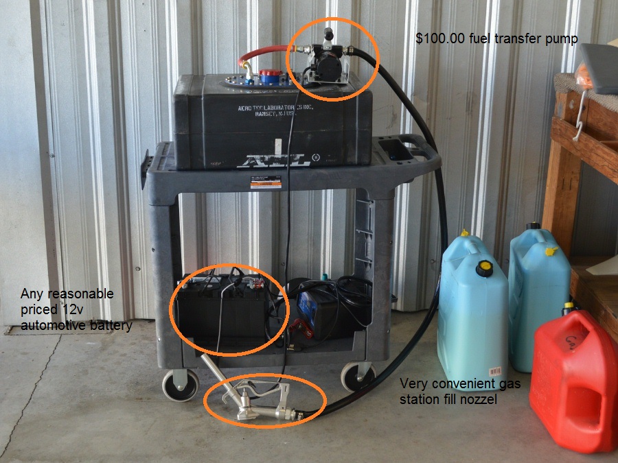

vernon smith 11-24-2017 08:06 PM
I'm using an old race car fuel cell bladder (ATL). Find some local race car shops and they will probably have some old ones laying around. You want the black hard plastic bladder. Northern tool sells a small 12v transfer pump with all the hoses and a gas station style filler nozzle for $100.00. It says diesel only but they have to say that. I use a large funnel with an automotive paint strainer into the tank.
https://www.northerntool.com/shop/to...2558_200612558
I use a light weight industrial push kart with the fuel cell on the top and the 12v battery and a charger on the bottom.
The top shelf on the push kart lines up well with the tail gate on the pickup so I can side the cell into the truck bed with minimal strain
Next time I go to the AP I'll take a picture.
Piper J3 11-24-2017 08:15 PM
I'd use a little caution here... "diesel only" means just that. There are similar style pumps made specifically for gasoline.
Just saying...

vernon smith 11-24-2017 09:22 PM
Before there is a mass migration to the "buy it at the airport philosophy" you should look at the fuels Rotax recommends, none of which are available at most local airports. Our field (PGN) is full of Rotax planes fueled by premium pump gas. Their hangers are full of five gallon lawn mower plastic cans. Hopefully, the fire marshal is sympathetic. I called the local Rotax dealer and high test pump gas is their number one recommended fuel, although I thought it would be 90 no ethanol.
If you are going to transport gasoline in any manner I suggest the best way, short of a semi truck, is a racing fuel cell designed to withstand impact collisions in excess of 200 mph. Additionally, the fuel cell comes with AN liquid transfer fitting in place, so all the normal aviation plumbing hardware screws into place.
I'm not making any recommendations as to how you should get your fuel to a location that does not have it available, I'm just telling you how I do it.

Here is a picture of my fuel cart. What I like about it;
It lines up well with the tail gate on the pickup, if you don't have a pickup this system still beats lifting the cans individually five feet off Terra firma.
You can take the furl out line off the fuel cell tank, extend it to a five gallon can on the floor, put the fuel nozzle (previously fuel out from the cell) into the fuel cell and fill the cell. This way you never have to lift anything off the floor or out of your trunk (remember, the cart has four wheels) As you may have surmised, I'm too old to be doing any of this.
The cart is composite, very light and purchased from Uline I think. I'll look it up is anyone cares to know.
The fill nozzle is very convenient, with no spillage.
I've pumped over fifty gallons with it without a battery charge.
The black fuel cell is standard circle track stuff, pricey new ($300.00) but cheap if you scout around your local auto racing shops. Everything is AN so it becomes a safe reliable integration.
What I don't like;
The cost adds up, I had the cell but if you bought it all new, over six hundred bucks.
It's one more d**n "system" that needs to be maintained, pampered and charged.
There has been some discussion about filtration. I fill the cell, whether at the gas station, or from five gallon cans, into a funnel with an automotive paper paint strainer. I have no idea what it's micron rejection is but will probably get a lesson on it shortly :D
bobnoffs 12-02-2017 04:56 AM
vern,
i have basically the same set up with a 55 gal. drum but my automotive fuel pump is very anemic for this purpose. can you name a supplier of your pump?
