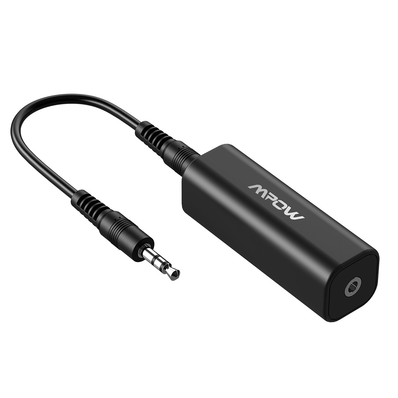

I had some annoying noise in my headset coming from my iPad after changing intercoms. I totally solved it by putting one of these in line between the intercom and the iPad:
https://www.amazon.com/gp/product/B0...?ie=UTF8&psc=1
Cheap, effective, easy and it may work for you.

Those ferrite chokes work best at radio frequencies. For audio frequencies, a "ground loop isolator" is worth a try, available on Amazon and eBay.
