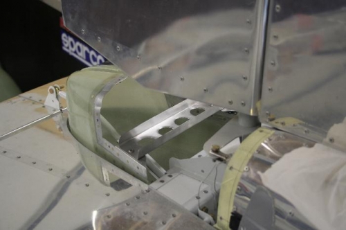

Tailcone fairing clearance issue
I am facing a clearance issue between the stabilator skin and the empennage fairing mounting screw. The issue is on both side, so the fairing is centered well.
Apart to this the fairing fits nicely.
My idea is to slightly trim the skin to gain clearance, but I d'rather ask the experts here what is best to do before I proceed.
Thanks for any inputs on this
Chris

D&M Dan 10-20-2017 11:17 AM
I used a sanding block with 80 grit paper and worked the edge so it appears to smoothly transition and clear the screw. I don't think I would notch it like that.
Rrhsch 10-20-2017 12:03 PM
Remove a screw on both sides of the fairing and run a safety wire folded in half between the two sides. I used a nail and washer to hold the wire on each side. Twist the safety wire against the nail to pull the fiberglass in just enough to give you clearance plus a little over bend. Then use a heat gun and gentility heat a LARGE area of fiberglass on both sides. Heat until it is too hot to hold your hand on it but not hot enough to burn the glass. Let it air cool to room temperature, remove wire and it should retain its shape. I did this with mine and it worked.:p
pazmanyflyer 10-20-2017 12:45 PM
Not building a 12 but couldn't you use a countersunk screw/tinnerman instead to give clearance?
sf3543 10-20-2017 01:04 PM
I had the same issue
Just installed countersunk screws and everything worked out fine.
rk2436 10-20-2017 08:39 PM
I just moved the whole fairing a touch forward and it solved the issue. Most -12's that you see you can tell they trimmed the HS skin half arsed.

I?d recommend that you get both fairing halves mated up and finish mounting in their final position before trimming the stabilator skins or making other adjustments for clearance.
RFSchaller 10-20-2017 09:40 PM
I had to trim the skin on one side when I built it. Later my stabilator bearings started slipping horizontally causing the skin to catch a screw head. Once I did the SB to threadlock the bearings I had no issues.

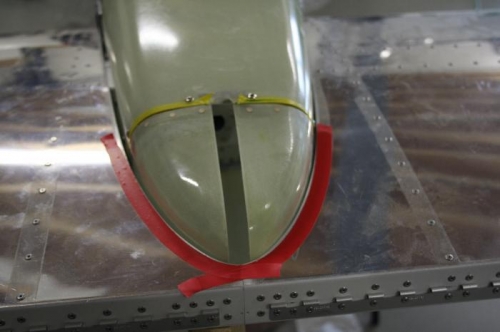

Gagarin737 10-21-2017 02:06 AM
Trimmed the stabilator skins and made a bracket to make the tailcone more rigid:
dbhill916 10-21-2017 02:14 PM
That looks very interesting. What kind of effects did it provide for you? Do you have a drawing of your bracket?
thanks,
-dbh
Gagarin737 10-21-2017 03:13 PM
thanks,
-dbh
No drawings available, it's a very simple bracket. When I made the tailcone I found the sides somewhat flexible and the sides where touching the stabilator. I tried the bracket and with that the tailcone really stays in shape.
Jeff Vaughan 10-22-2017 07:47 AM
I had the same issue. I used a nibbler and my dremel with a sanding drum to create the needed clearance.
