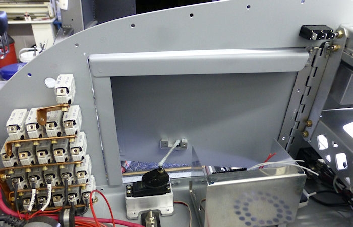

joedallas 05-27-2017 07:03 PM
Arduino microcontroller
Experimenting with the Arduino microcontroller to perform some small tasks in the Aircraft.
http://joesrv12.com/Builder%20Log/bl_42_11.htm
Has anyone used this in a their aircraft.
Joe dallas

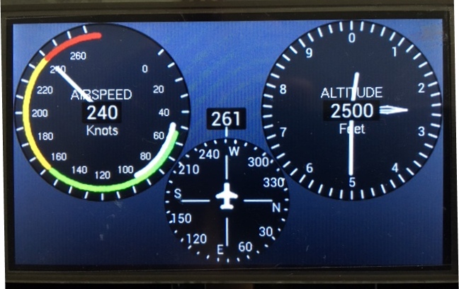

madmaveric 05-28-2017 07:24 PM
Some interesting stuff there (shame we would have to get a mod approved for most of this in the uk).
Have you looked at the ESP8266? It's ideal for when you don't want to run wires. It is a tiny low power (3.3v/~800ma) programmable, stand alone, wifi module. Using two of them, or one and a tablet/phone, you could easily have a wireless link setup.
I've been playing with one for decoding and displaying the PilotAware data (a beefed up version of the Stratux system you have in the US). It might end up being useful for microlights where space and weigh is a big issue. A bit of Velcro would easily hold it up where you want it with no wires.
I did a video showing the ESP8266 to show the size of it, I hadn't received my circuit boards for the voltage regulator at this point so it is running off 2xAA batteries.
In the video there are 4 parts. a 3D printed case, the screen, the ESP8266 (the small board) and the batteries. The final one will have a lipo with charger and regulator but you get the idea from this as to how small they are.
This one has a description of the screen layout and what is going on, this was early on so it is still all on a breadboard.
Not having tested this in a real aircraft I don't know if it will be any good (it might not be readable or cause interference) but for now it is fun playing round with it when I'm not building
The thing I like about these modules is they are tiny and need very little power. For most projects you can replace the Arduino with one of these and have a smaller/lighter/cheaper system.
A quick search on youtube will show the kind of things people are doing with them.
Just thought I would point them out for anyone who hasn't come across them yet. I haven't used my arduino since getting these :D

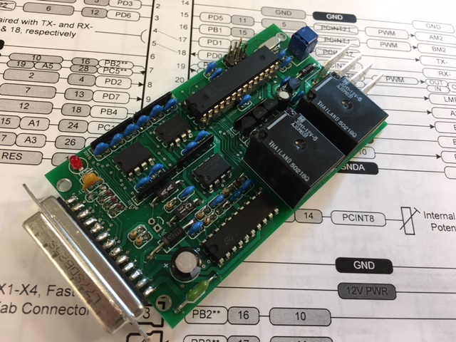

vlittle 05-29-2017 10:16 AM
Aviation-grade Arduino Controller
I've been heads down developing an aviation-hardened Arduino compatible controller.
This project started when I was discussing the procedure for a go-around in my Harmon Rocket with my wingman (Power up, stick forward, flaps up, trim down, call tower). He mentioned that I should just build a gizmo that would do the flaps and trim for me.
Since I was already flying behind an auto-trim controller that I developed several years ago, I took this challenge on and reprogrammed the controller (in PIC assembly language) to implement this function. Everything worked out and now I have a single button push to dial in my flaps and trim. It even measures acceleration and runs the flaps all the way up if it predicts that I may exceed VFE in the go-around.
I realized that many others may want a similar gizmo in their aircraft, but I wanted to move to the Arduino platform for ease of developement. The Arduino stuff is great, but it doesn't do a lot without adding on or designing custom shields, power supplies and packaging. The aircraft electrical and RF environment is pretty harsh. In fact, most of the avionics devices I have designed have most of the cost and circuit board area devoted to protecting the device from the environment (60 volt load dumps, reverse polarity, overvoltages on inputs, strong RF...).
So I developed an aviation-hardened Arduino compatible board called the Falcon-AVR. The prototype has just finished Beta trials (one was replicating the auto-trim controller (1600 lines of C code), the other a marine instrument application). I have just implemented a board revision so that I can easily add-on WiFi or BLE or I2C modules, and support 28 Volt operation.
My intention is to go 100% open source on this design.
See this link for complete documentation.
My intention is to provide blank circuit boards (plus a Digi-Key parts list) to interested folks. There are are assembly options, so some hardware smarts are required. Send me a p.m. if you are interested. Photo of initial proto below.
Cheers, Vern

petersb 05-29-2017 02:12 PM
Vern, maybe you can help me. I need to protect the arduino H Bridge from back emf when I use the backup flap switch. Usually a diode is installed across the DC motor, however, our flap motors are bidirectional. Any thoughts ?
vlittle 05-29-2017 05:39 PM
You need to add external catch diodes on the motor driver's outputs. You would need a total of 4 diodes. They connect from power and ground to each of the motor driver outputs. They are normally reverse biased and only conduct with back emf. They are labeled D1...D4 below. Use 1N5400 diodes.
On the Falcon-AVR, I chose to use relays to drive the flaps (or lamps or pumps) because they can be 'hostile' loads. Instead of catch diodes, I used a bidirectional Transzorbs, but the principal is similar.
V

vlittle 05-29-2017 08:08 PM
Originally Posted by petersb (Post 1176480)
Thanks Vern
In my setup the arduino activates an Elecrow H bridge that then feeds through a relay to the motors. On the NO side of the relay is a manual flap/trim switch so I can still operate the flap/trim if the arduino fails.
With the arduino off, when I operate the flaps with the backup switch, on release of the switch the LCD display attached to the arduino momentarily flashes. It seems the back emf is going through the relay NC side and through the bridge and into the Arduino.
So I need to stop the back emf on both leads to cover up and down flap operation
Could I connect a MOV across the flap motor ?
I misunderstood your question. Your drivers already have the catch diodes, and they are causing the back power feed into the Arduino. This is one of the reasons I used relays for the flaps on the Falcon-AVR... no back power feed is possible.
To prevent this, you have to have isolated power, which is a challenge with semiconductor motor drivers.
A MOV or a Transzorb won't prevent back feed because you can't fine tune the clamp voltage accurately. I would try the 4 diodes but to a completely separate 12V and ground. You may also try schottky diodes so that the catch diodes in the MOSFETs don't engage. This should do the trick.
Edit: further reflection says that your Arduino must be powered at all times. The lack of circuit isolation is a challenge to overcome. It's what I meant by 'aviation hardened'. There are a lot of little gremlins when using the Arduino stuff in an aircraft environment.
V

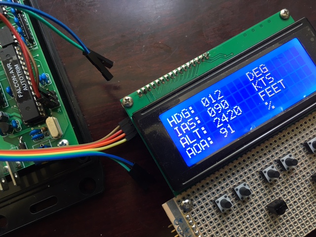

olegusan 05-30-2017 07:39 AM
More Arduino avionics
It is great to see experimental aviation going beyond rivets!
Here is the stuff I've been working on if anyone interested
Arduino based EFIS: http://experimentalavionics.com/efis-19264-ver-1-2/
Some video here: https://youtu.be/emqc_vi7-Rg
... and here: https://youtu.be/oVMNnUio5Sg
EMS: http://experimentalavionics.com/engi...gement-system/

vlittle 06-05-2017 03:53 PM
Originally Posted by vlittle (Post 1176744)
I'm organizing an order for the Falcon-AVR final version pcbs. These are 4-layer boards and I'd like to get 20 boards ordered and in the hands of Arduino fans within a month. http://vx-aviation.com/documents/Falcon-AVR/
I already have three people signed up for blank boards. If anyone else is interested, please send me a PM.
Thanks, Vern
A few folks have asked me about component costs for the Falcon-AVR.
Here's a breakdown of the options:
28 Volt, field configuration (includes case, primary input protection, etc.) $68
14 Volt, field configuration (includes case, primary input protection, etc.) $57
28 Volt, lab configuration (no case, only secondary input protection) $52
14 Volt, lab configuration (no case, only secondary input protection) $40
I would recommend starting with the lab configurations, then adding components as required by the application to get to a customized field configuration.
The costs were derived from Digikey's low volume pricing. Careful shoppers and those who buy in quantities can probably reduce the cost by 50%.
I'm still trying to get a group together to share the cost of a pcb order. PM me if interested.

Falcon-AVR demo program
Here's an example of a simple C program (Arduino sketch) that shows how easy it is to process Dynon or Garmin serial information using the Falcon-AVR here.
This program displays:
HDG
IAS
ALT
AOA
on a 20 x 4 LCD screen as a 'backseat' display. The ALT is corrected altitude using the barometric pressure setting.
It took about an hour to write, which is pretty good because 'C' is relatively new to me (... I remember FORTRAN...)! I cut it down from a 1600 line program (auto-trim controller) just to demonstrate the function.
I have a graphics display module that would be very cool to use for virtual instruments, but that's a different project!
V

vlittle 06-09-2017 02:51 PM
HDG
IAS
ALT
AOA
V
Here's the text display. Ignore the pushbuttons and IR receivers. The graphical display is working fine, just needs more time behind the keyboard to finish up.

vlittle 06-23-2017 10:30 AM
Update on Falcon-AVR order group buy
Some good news and some not so good news.
I am less than a week away from making a decision on the group buy of Falcon-AVR printed circuit boards. I'm a little short of the minimum quantity of boards I need to order, so now is the time to get ahold of me (via PM), or (ahem) pay your PalPal invoice!
I am not making any money on this, and will probably have to subsidize the purchase by $100 or so!
Now the good news: I have completed the design of an option board that allows a Teensy 3.2 to directly plug into the Falcon-AVR instead of the ATMega 328.
This will increase computing speed by about 10x and allow much larger programs to run on the board. More information on the option board (aka Talon-AVR) will come in July, but it also includes a second hardware serial port for more throughput when using add-on boards (for example BlueTooth and WiFi).
Thanks to everyone who has supported this project so far, I hope more can join in.
Vern
vlittle 06-24-2017 04:54 PM
Falcon-AVR group buy minimum quantity achieved!
Thanks folks! I have released the pcb order to manufacturing based on my MOQ of 10 boards. I was hoping for 20, but c'est la vie.
It will take about 10 days for me to receive the boards. Give me two weeks to completely assemble and debug one board to verify the design before I begin shipping the blank pcbs out to my backers. The good weather may get in the way.
I will be verifying both 14V and 28V [actually 60V] versions.
Oh... I will also be verifying the Teensy 3.2 version....!

vlittle 06-27-2017 07:53 PM
Tape-out
In the vernacular of the semiconductor industry from the last century, when a database file is released to manufacturing, we called it 'tape-out'.
In my case, it was just pushing buttons on my Cad software, but the result is the same... manufacturing will take about 7 days, shipping to me (in Canada) a few more days, then I'll perform verification.
I'm also checking out a 'desktop' configuration that strips your the Falcon-AVR down to a glorified Uno-like device which can then be upgraded to the 'lab' or 'field' configurations later on. The whole point is flexibility, which is why it's all through-hole.
As I mentioned previously, there will also be an applique board that will allow a Teensy 3.2 to plug in for those who like more horsepower. This will be available in August. In addition to the horsepower, it will also support a second hardware serial port for higher performance WiFi or Bluetooth support. I have already tested Bluetooth connections that allow a 9600 bps connection between a Dynon EFIS and the Falcon AVR. I need to run this interface at 115,200 bps, but that takes a bit more effort.
