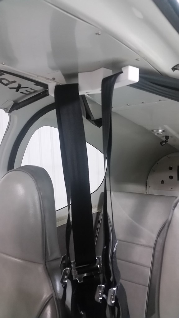

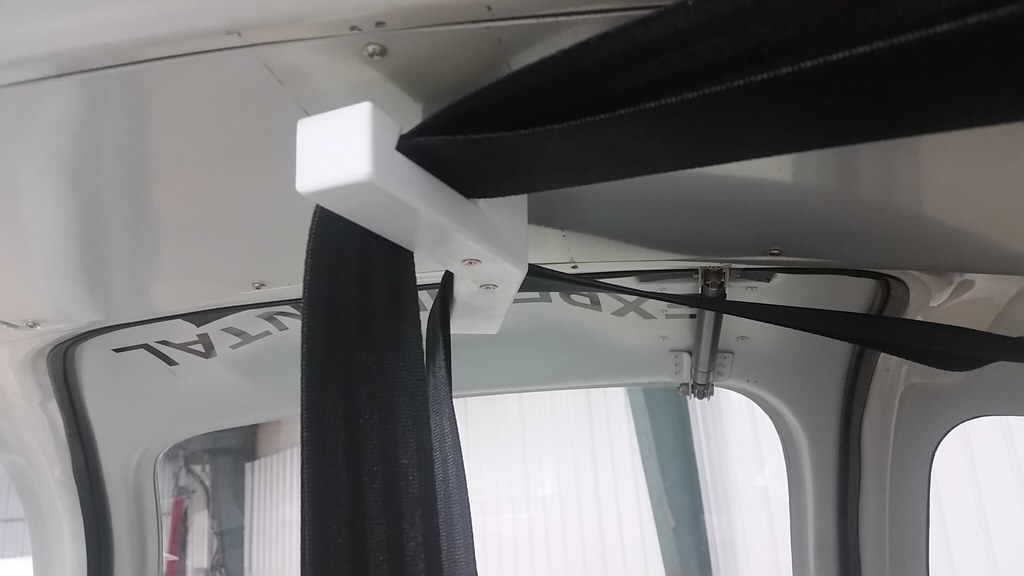

Previously I made a seatbelt bracket out of foam and then covered it with fiberglass. Took a long time to smooth and make nice (~6-8hrs of labor).
Used the same dimensions and printed one for another RV-10. Took about 30 min to draw on Solidworks and then about 4 hrs to print but I just walked off and picked up the finished part later in the day. Much easier.
You can make one from here

Weasel 02-21-2017 08:08 PM
I printed it with 0.2mm layer height, 40% infill and 4 perimeters with 3 or 4 solid layers top and bottom.
Used ABS material.
Also printed it pretty slow. ~30-50mm/sec
