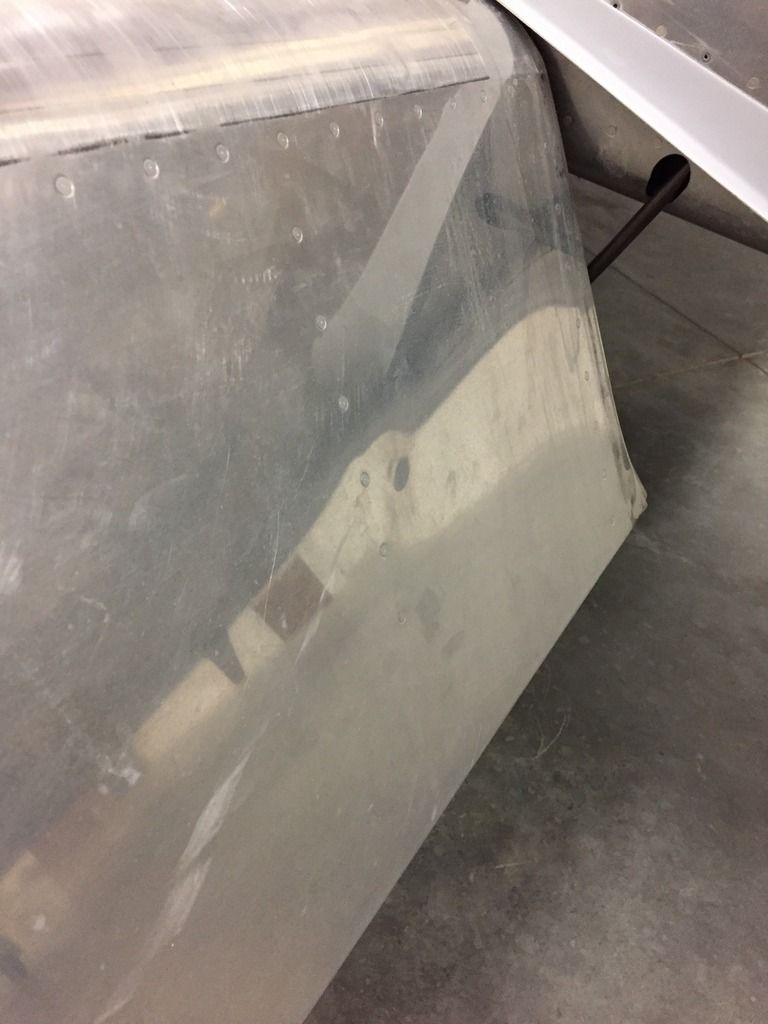

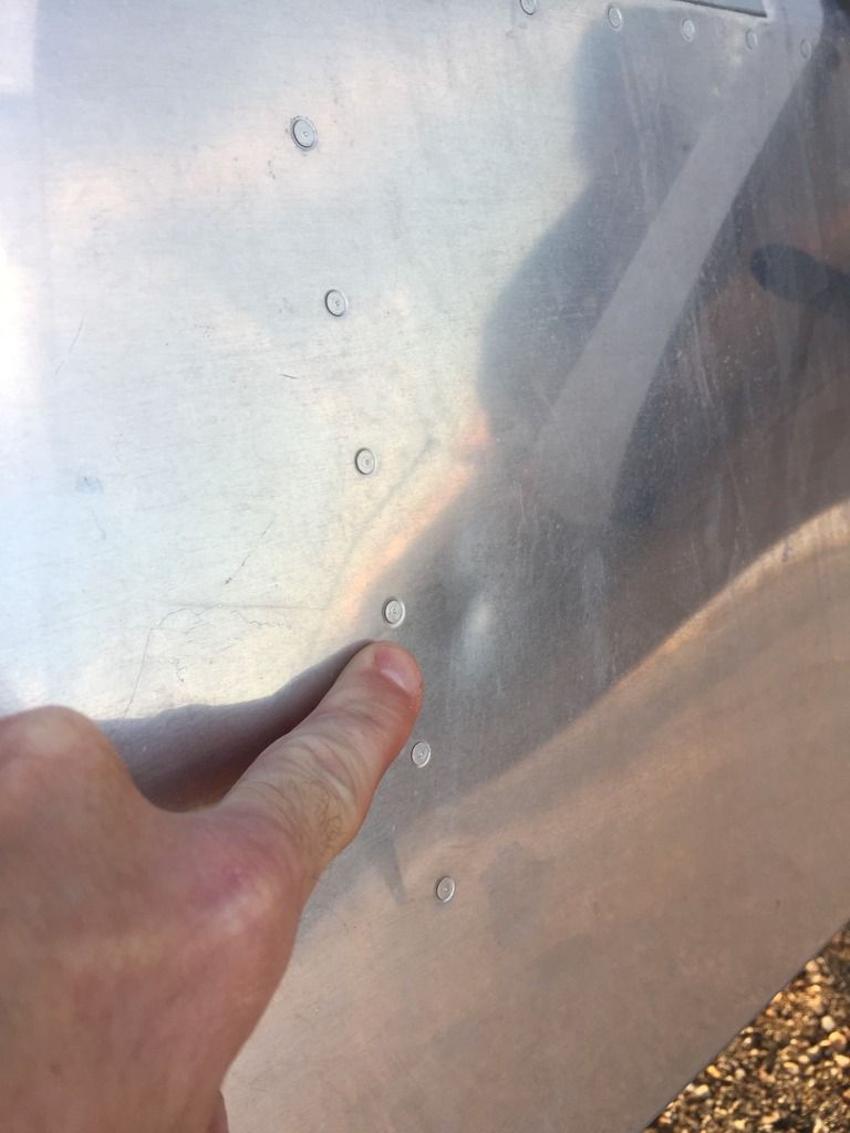

Well, walked out to my 8 on the ramp at Kickapoo today and saw a small dent on the top of my flap. No idea what happened..... is this repairable? I didn't build the plane, so I haven't done sheet metal work, and I hope it's not a "you're gonna have to just use filler." I'm based at Ogden and there's a "aircraft restoration and paint shop" here but haven't talked to them. Open to some pointers.

I'd ignore it and go fly. Hangar (or ramp) rash, doesn't look like anything sharp hit it (meaning no likely crack initiator).

RV8Squaz 11-14-2016 06:07 AM
Call a paint-less dent repair guy. Many body shops and car dealers will have a relationship and contact info for a paint-less dent repair company. They are usually called to repair hail damage on vehicles. And, since many vehicle bodies are made of aluminum, they're used to working with it. They use little pry tools to get into the smallest spaces and work the metal back into shape. A flap would be very easy for them to do.
I had some workshop rash, errant rivet gun/bucking bar dings repaired before paint. I also had some light to moderate hail damage post paint that was repaired flawlessly! It is relatively inexpensive and very quick. I had about 20-25 dings due to hail. It took the guy about 2 1/2 hours and he charged me about $200. I think half the time we were talking about the RV and flying!

Looks like it was caused by the toe of a shoe. Looks quite minor to me.

Marc Bourget 11-14-2016 03:56 PM
Jerry,
I don't think automobiles use the same alloy as aircraft.
In a similar repair to the bottom of a wing, the DER spec'd a patch of the same thickness with approximate 1/2" rivet spacing around the perimeter.
FWIW
