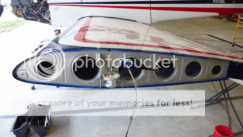

I'm looking for information on mounting the Garmin GMU 22 magnetometer in the RV-10's wing tip. Anyone have any suggestions, warnings, hints, photos, etc. that would help me with this?
In doing a search for Magnetometer or GMU 22 in this forum, I see several posts regarding mountings, with most people apparently mounting it in the tail cone behind the baggage bulk head, with a few people saying theirs is in their wing tip, but I couldn't find much regarding wing tip mounting.
Since I am installing an Airflow Systems air conditioner with the blower motor mounted just behind the bulkhead, I believe the magnetic field interference from the motor will make that location unsuitable for a magnetometer.
I am installing the AeroLEDs Pulsar NS stobes and AeroSun VX wig-wag landing lights in the wing tips but am hoping these won?t be a problem for the magnetometer with a wing tip mounting location? Any thoughts on this assumption?
Any and all advice regarding magnetometer locations, including possible alternative mounting location possibilities will be greatly appreciated.

Here is an old thread that refers to an RV-8 wingtip mount of the GMU 22. We did move the location forward because of some interference we were getting from aileron movement in flight and that appears to have eliminated a few interference alerts we got on the G3X Touch during Phase I. I'll try to attach a photo of the new location. Here's the link:
http://www.vansairforce.com/communit...=gmu22+wingtip
And here's the photo of the moved location of the GMU 22. We've been flying it at this location for over a year with no problems at all.

I have my GRT magnetometer mounted in a wingtip with Aeroled Pulsars. Seems to work fine.
vic syracuse 11-09-2016 04:59 AM
I have mounted them in the wingtips of RV10's and they work fine.

Thanks everyone. Sounds like wing tip mounting is the best location for my RV-10.
I appreciate the warning about keeping it forward to avoid interference from the aileron leading edge tube, as I was originally thinking it might be best towards the trailing edge to keep it away from the lights. However with the warning regarding aileron interference and having installed a negative ground return wire out to the landing/taxi lights, and a shielded 3 conductor for the Pulsar NS position/strobe lights with the shield as the ground return wire (per AeroLED's recommendation), mounting the magnetometer towards the leading edge it is.

As specified in section 13 (GMU 22 installation) of the G3X Installation manual:
  1. Ensure that any electrical conductor that comes within 10 feet (3.0 meters) of the GMU 22 is installed as a twisted shielded pair, not a single-wire conductor. If possible, the shield should be grounded at both ends.
  2. A dedicated power ground should be used and returned as a twisted pair with the power source back into the fuselage for a wing mounted GMU 22.
Using the shield as a power ground return for your wing tip lights is not recommended.
