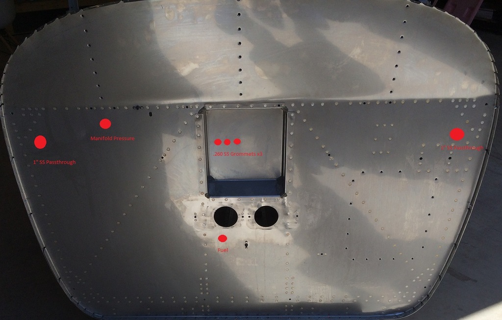

You're question is very timely, I was about to ask the same thing. I did buy two of the 1" SS pass threws, I was wondering if you just enlarge the two holes in the image below to be 1" or are these earmarked for something else, I looked through the plans and can't really see that these are for anything else:
I can't see your image but if that is the roughly thumb-sized holes left and right on the firewall, that is indeed what they are intended for. However, I am using sealed CPCs for my passthrough and the extended sleeve (about 3 inches) would have interfered with the motor mount, so I covered the existing holes with riveted stainless steel covers and relocated my openings. My point is that you can relocate things as needed and appropriate for your installations.
Thanks, can other's not see my image? I have been having a hard time moving from picassa to goggle photos.
cant see it either...
Make sure you share the photo first and then change your link.
Ok, how about now:
Yup, I can see both now :)
Not many people have chimed in. I'm also interested in what people have done. I've been stalling drilling mine, but I'm about finished with the avionics and will be riveting my panel substructure in soon and would rather install the passthrough prior.
I'm thinking I will use the existing LH hole for my battery cable, install a 1" firesleeve passthrough near the center, and use the RH passthrough hole only if I were to run out of room in the 1" hole. :confused: |

I'm using the SS fire-sleeve pass throughs from ACS you've mentioned. I ended up with one of each size. The interior firesleeve eats up a lot of space. The #2 battery I bring through the existing hole which I enlarged for a bulkhead fitting. The smallest SS pass-through I've got on the top-left of the firewall and will be using for ignition related wires. The 3/4" pass-through I've got in the little slot designed for the heat boxes and alternate air door. The 1" pass-through I've got on the upper right for all the thermo-couple wires and various other engine monitor wires. Van's has you drill another hole for a bulkhead fitting if you position the manifold pressure sensor on the inside. The existing hole on the far right I probably could have used for the 1" SS pass-through but didn't, thinking I would use it for something else. I'm going to plug that one.

You probably want a separate pass-through for the battery cable. Keep power wires away from sensor wires. I didn't want to take a chance on the cable chafing and possibly arcing on the firewall, so I used a marine insulated firewall pass-through terminal.
I assumed the battery/power line came through the 1" Pass through on the right. And the left one was for all other wires...
Good deal, I actually made some solid progress on everything last night. Going to order another 3/4 inch pass-though for alt air/ and heater cables. Also need to order some Stainless Steel pull rivets to attach these passthroughs. Tried to use screws but the backside is really close to some brackets so pull rivets will work best.
