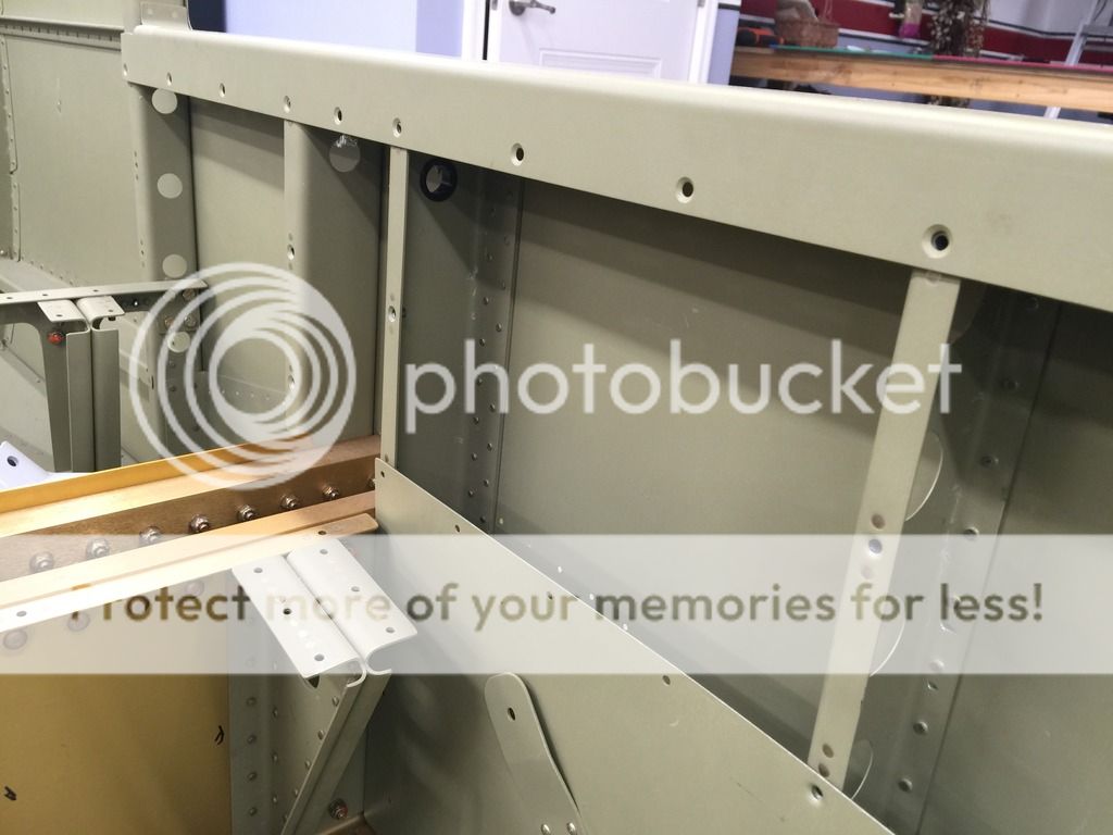

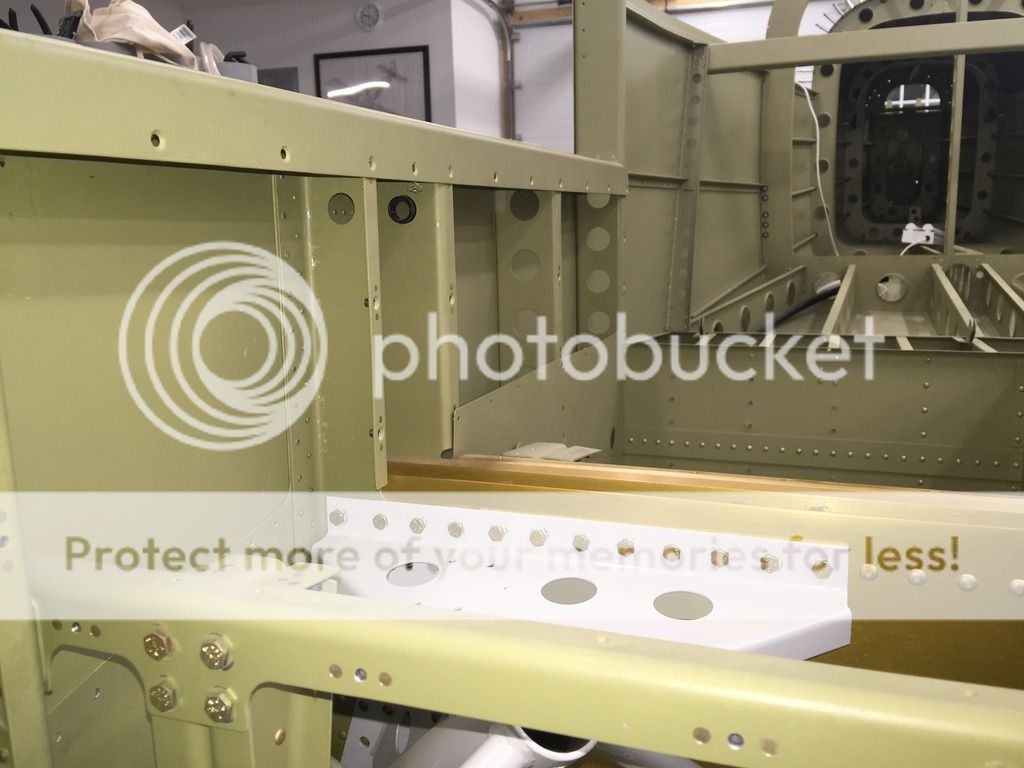

Contemplating wire runs from the battery and tail forward to the cockpit/panel area, while my build is at the full-length canoe stage. I see lightening/pass-through holes aplenty in the bulkheads on the right side, but they vanish at the spar web carry-through. What's the secret for routing cables forward further than the spar center section? Can they go over the spar but under the front seats? I lack a completed 10 to look at, so any description of what I should be doing to install conduit and route cables from tail to nose while I have decent access to the aft tail cone area would be appreciated.

So, it's okay to drill holes in those side formers that attach to the spar web below the door opening (Sorry - no plans with me at work today for proper part call-out). Mine are presently undrilled, and I was not sure it was okay to violate them :(
Makes perfect sense, though. I presume one stays small and in the center of the web with whatever holes are needed here.

Bill Boyd 08-03-2016 08:03 AM
Looks like only one hole to start with
I didn't even notice the hole was there, complete with bushing, until I took the pics last night to post here, but there is one predrilled factory hole at the top of the F-1004 C and D's. It's visible in the pics. Curiously, the plans I have (Rev. 0) show two holes per piece on pp. 28-1, 28-9 Fig 1, for example.
Good to know the factory approves additional holes here.
Mike, your pics show the F-1042's primarily, but I can see there must be some extra penetrations of the F-1004-C's and D's as well for the cables I see. Am I right?
Kyle Boatright 08-03-2016 08:32 AM
Bill,
I think you'll find another set of fore and aft holes in those bulkheads, up higher and hidden by the structure under the door opening.
Bill Boyd 08-03-2016 09:30 AM
...and
I'd be willing to bet you're right, Kyle. Will eat crow here tonight after I poke around up there with a fingertip to verify.
Looks like Mike's B+ fat wire goes through lower down, through his additional hole. It's all coming into focus now. I'm one with the Force...
Bill Boyd 08-04-2016 07:02 AM
Yep
Two factory holes in each piece. Upper ones hidden under the "gunwhale" just as predicted. And here I thought I had done a pretty thorough inspection of the previous workmanship that had brought this slow build kit to the QB-stage.
