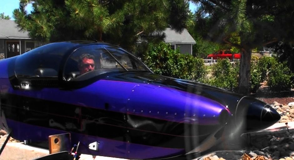

bret 07-03-2016 03:41 PM
test run.....at home
https://www.youtube.com/watch?v=76OP...ature=youtu.be

Paint is stunning. Nice! And like your anchor in the back too. Coolest Neighbor around :)

Congrats!!! So satisfying when the Lycosaurus first coughs to life. The purple paint looks awesome...now that the engine runs, the "EKG" graphics have new meaning. :D

bret 07-03-2016 06:17 PM
Thanks all, now to sell that car or boat to pay for the rest of the Dynon stuff. Very happy with the EFII system, would have started in 1.5 seconds but I had the throttle open.....OPPS! Robert at EFII has awesome products and support! just noticed, check out the gal across the street walking into her house......(nothing to see here, move along. Just Bret with another hot rod engine thing......wait, is that a Prop) ?

bret 07-03-2016 07:14 PM
One thing I discovered after painting this, was that a metallic paint will appear to be a lighter color in the sun than it will in low light, I like the look of this paint at dusk, but I would have liked to have gone to a darker purple, playing with saturation and other stuff, this is what it looks like in low light.....O well, it is what it is,

DanH 07-04-2016 07:29 AM
Originally Posted by bret (Post 1092388)
Guys, let's anchor to the tops of the gear legs, not the steps.
bret 07-04-2016 07:36 AM
Good idea Dan, less of a twisting arm. Hey, maybe this is how those non flown steps get cracks in them.....:rolleyes:

swisseagle 07-05-2016 06:39 AM
Not without the wings on!
Vans was somwhere writing that you should not do this, because the wings act as mass dampener, also you should installed the rear baggage compartment wall due to structural integrity. There is a lot of twisting on such a fuselage.
Think about the gear-weldment ... the bolts that carry most of the load ar the wing-bolts ...
Upto you, nice paint, great milestone, congratulation!
Brantel 07-05-2016 08:05 AM
Cool video but too much risk for me. There are at least a half dozen things that could have gone wrong there that thankfully did not.
For me the juice is not worth the squeeze....
But hey, if they had at least it would have been on video and most likely would have gone viral.... :p
The paint is awesome!
bret 07-05-2016 09:58 AM
Yip, rear wall and gear bolts were installed. As far as dampen, this thing runs smooth as silk with EFII ;-)
