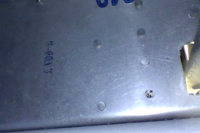

f14av8r 05-15-2016 03:14 PM
RV-4 No Cracks
Inspected my 1993 start 2000 completion RV-4 with 1050 airframe hours - NO CRACKS. I've flown a lot of aerobatics during the last 150 hours but I don't think the previous owner flew aerobatics often.
The first photo is a cell phone photo and was adequate to the task but the borescope provided a little closer look.
Cell Photo
Borescope
